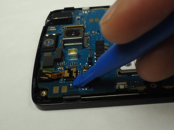

    1. LG Tribute Motherboard Replacement, Motherboard: crwdns2935265:05crwdnd2935265:01crwdnd2935265:01crwdne2935265:0
      • Use a plastic opening tool to disconnect the touchscreen from the motherboard.
      • The motherboard will be completely free from the front panel after this step.

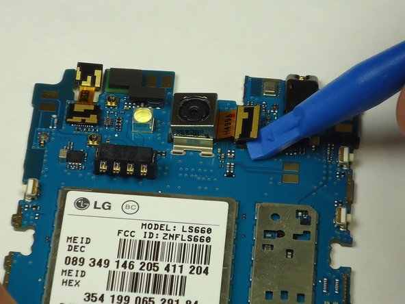

    1. LG Tribute Motherboard Replacement, Motherboard: crwdns2935265:06crwdnd2935265:01crwdnd2935265:03crwdne2935265:0 LG Tribute Motherboard Replacement, Motherboard: crwdns2935265:06crwdnd2935265:02crwdnd2935265:03crwdne2935265:0 LG Tribute Motherboard Replacement, Motherboard: crwdns2935265:06crwdnd2935265:03crwdnd2935265:03crwdne2935265:0
      • Remove SIM card by sliding it out of its housing.
      • Remove the front-facing camera using a plastic opening tool.
      • Remove rear-facing camera using a plastic opening tool.
      • Connect these three components to the new motherboard.
