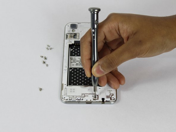

  3. LG Tribute HD Rear Speaker Replacement, Rear Speaker: crwdns2935265:03crwdnd2935265:01crwdnd2935265:02crwdne2935265:0 LG Tribute HD Rear Speaker Replacement, Rear Speaker: crwdns2935265:03crwdnd2935265:02crwdnd2935265:02crwdne2935265:0
    • Remove the twelve 2mm JIS #00 screws from the mid-frame.

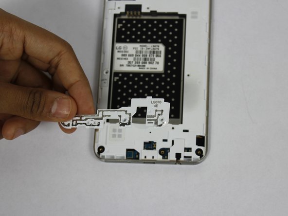

  4. LG Tribute HD Rear Speaker Replacement: crwdns2935265:04crwdnd2935265:01crwdnd2935265:03crwdne2935265:0 LG Tribute HD Rear Speaker Replacement: crwdns2935265:04crwdnd2935265:02crwdnd2935265:03crwdne2935265:0 LG Tribute HD Rear Speaker Replacement: crwdns2935265:04crwdnd2935265:03crwdnd2935265:03crwdne2935265:0
    • Using a plastic opening tool, remove the antenna extender from the mid-frame.

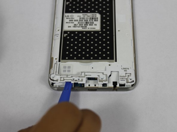

  6. LG Tribute HD Rear Speaker Replacement: crwdns2935265:06crwdnd2935265:01crwdnd2935265:01crwdne2935265:0
    • Using a plastic opening tool, pry the rear facing speaker from the panel.
