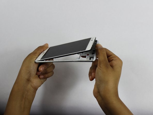

      • Insert a fingernail, or plastic opening tool, into the cutout on the back cover and pry outward to remove.
    2. LG Tribute HD Rear Camera  Replacement: crwdns2935265:02crwdnd2935265:01crwdnd2935265:02crwdne2935265:0 LG Tribute HD Rear Camera  Replacement: crwdns2935265:02crwdnd2935265:02crwdnd2935265:02crwdne2935265:0
      • Pull the battery out of the phone.
      • Remove the SD Card by sliding the card out as shown.

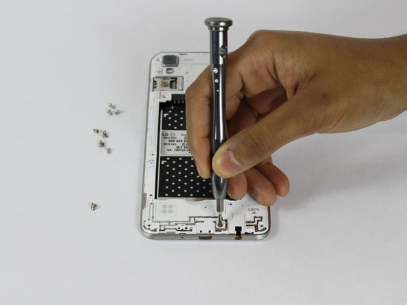

    1. LG Tribute HD Rear Camera  Replacement, Rear Camera: crwdns2935265:03crwdnd2935265:01crwdnd2935265:02crwdne2935265:0 LG Tribute HD Rear Camera  Replacement, Rear Camera: crwdns2935265:03crwdnd2935265:02crwdnd2935265:02crwdne2935265:0
      • Remove the twelve 2mm JIS #00 screws from the mid-frame.

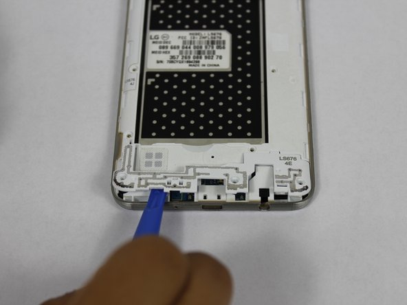

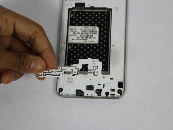

      • Using a plastic opening tool, remove the antenna extender from the mid-frame.

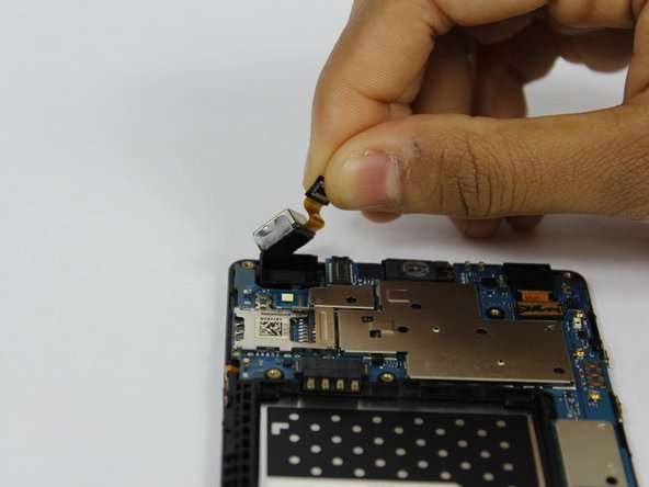

    4. LG Tribute HD Rear Camera  Replacement: crwdns2935265:06crwdnd2935265:01crwdnd2935265:02crwdne2935265:0 LG Tribute HD Rear Camera  Replacement: crwdns2935265:06crwdnd2935265:02crwdnd2935265:02crwdne2935265:0
      • Use a plastic opening tool to disconnect the rear camera and pull from the phone.
