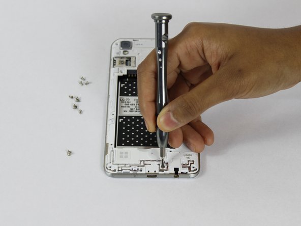

    • Remove the twelve 2mm JIS #00 screws from the mid-frame.

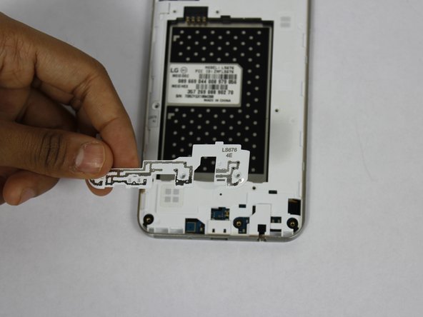

    • Using a plastic opening tool, remove the antenna extender from the mid-frame.

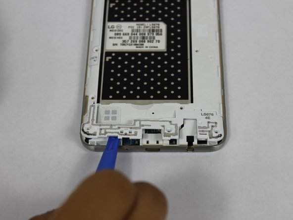

    • Using your fingers, remove the mid-frame.

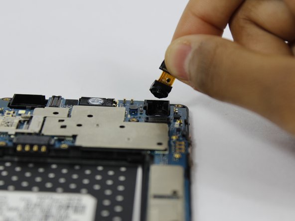

    • Use a plastic opening tool to disconnect the front and rear cameras from the motherboard and pull out to remove.

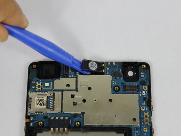

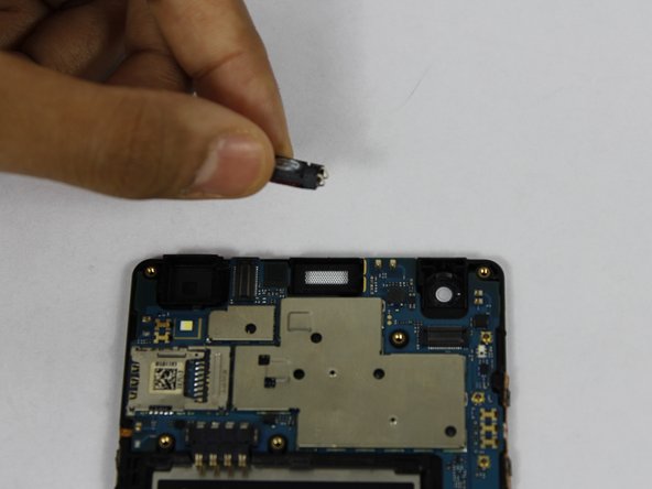

  7. LG Tribute HD Motherboard Replacement: crwdns2935265:07crwdnd2935265:01crwdnd2935265:03crwdne2935265:0 LG Tribute HD Motherboard Replacement: crwdns2935265:07crwdnd2935265:02crwdnd2935265:03crwdne2935265:0 LG Tribute HD Motherboard Replacement: crwdns2935265:07crwdnd2935265:03crwdnd2935265:03crwdne2935265:0

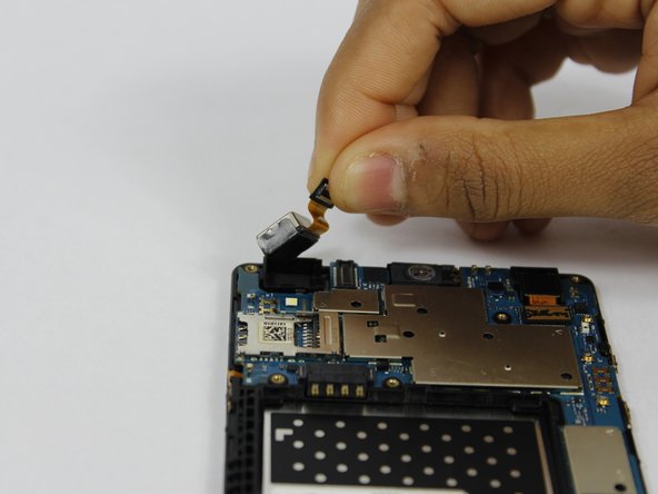

    • Using a plastic opening tool, pry up the front facing speaker and remove from the phone.

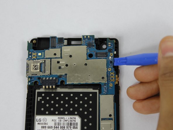

    • Use a plastic opening tool to pry up the motherboard and pull out to remove.
