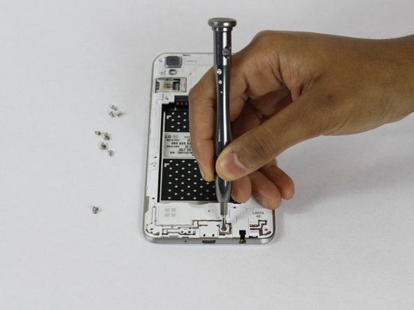

  3. LG Tribute HD Headphone Jack Replacement, Headphone Jack: crwdns2935265:03crwdnd2935265:01crwdnd2935265:02crwdne2935265:0 LG Tribute HD Headphone Jack Replacement, Headphone Jack: crwdns2935265:03crwdnd2935265:02crwdnd2935265:02crwdne2935265:0
    • Remove the twelve 2mm JIS #00 screws from the mid-frame.

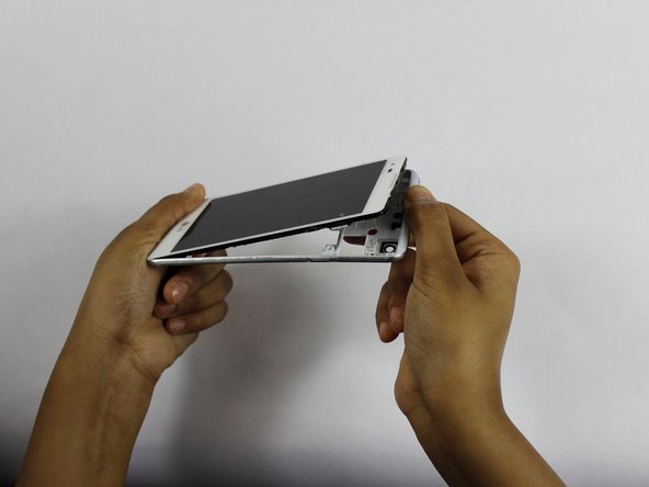

    • Using a plastic opening tool, remove the antenna extender from the mid-frame.
  5. LG Tribute HD Headphone Jack Replacement: crwdns2935265:05crwdnd2935265:01crwdnd2935265:02crwdne2935265:0 LG Tribute HD Headphone Jack Replacement: crwdns2935265:05crwdnd2935265:02crwdnd2935265:02crwdne2935265:0
    • Using your fingers, remove the mid-frame.
  6. LG Tribute HD Headphone Jack Replacement: crwdns2935265:06crwdnd2935265:01crwdnd2935265:03crwdne2935265:0 LG Tribute HD Headphone Jack Replacement: crwdns2935265:06crwdnd2935265:02crwdnd2935265:03crwdne2935265:0 LG Tribute HD Headphone Jack Replacement: crwdns2935265:06crwdnd2935265:03crwdnd2935265:03crwdne2935265:0
    • Use plastic opening tool to pry up the flex cable from the back panel.
    • Flip over and push on the back side of the headphone jack to dislodge it.
