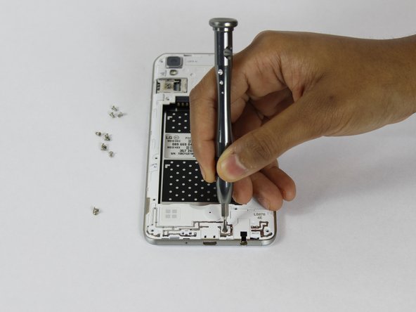

    1. LG Tribute HD Front Camera Replacement, Front Camera: crwdns2935265:03crwdnd2935265:01crwdnd2935265:02crwdne2935265:0 LG Tribute HD Front Camera Replacement, Front Camera: crwdns2935265:03crwdnd2935265:02crwdnd2935265:02crwdne2935265:0
      • Remove the twelve 2mm JIS #00 screws from the mid-frame.

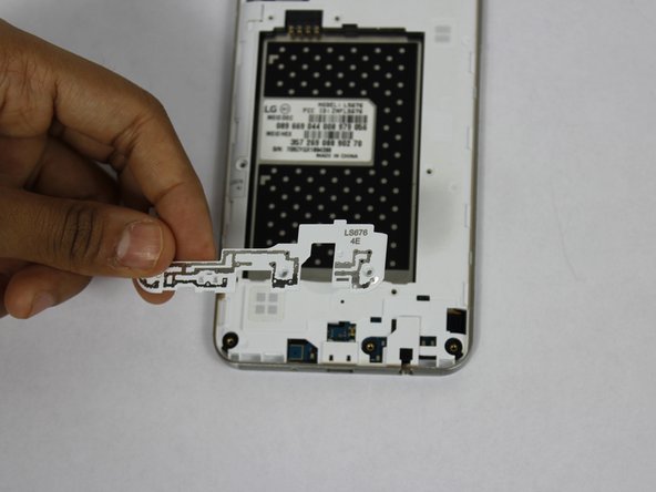

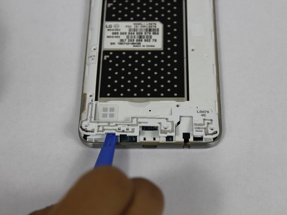

    2. LG Tribute HD Front Camera Replacement: crwdns2935265:04crwdnd2935265:01crwdnd2935265:03crwdne2935265:0 LG Tribute HD Front Camera Replacement: crwdns2935265:04crwdnd2935265:02crwdnd2935265:03crwdne2935265:0 LG Tribute HD Front Camera Replacement: crwdns2935265:04crwdnd2935265:03crwdnd2935265:03crwdne2935265:0
      • Using a plastic opening tool, remove the antenna extender from the mid-frame.

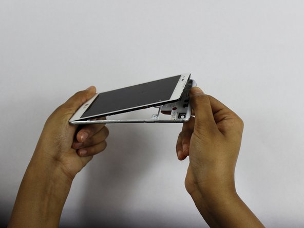

    3. LG Tribute HD Front Camera Replacement: crwdns2935265:05crwdnd2935265:01crwdnd2935265:02crwdne2935265:0 LG Tribute HD Front Camera Replacement: crwdns2935265:05crwdnd2935265:02crwdnd2935265:02crwdne2935265:0
      • Using your fingers, remove the mid-frame.

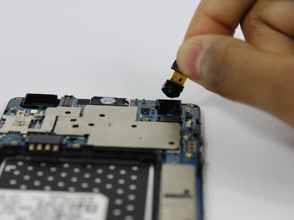

    4. LG Tribute HD Front Camera Replacement: crwdns2935265:06crwdnd2935265:01crwdnd2935265:02crwdne2935265:0 LG Tribute HD Front Camera Replacement: crwdns2935265:06crwdnd2935265:02crwdnd2935265:02crwdne2935265:0
      • Use a plastic opening tool to disconnect the front camera from the motherboard and pull out to remove.
