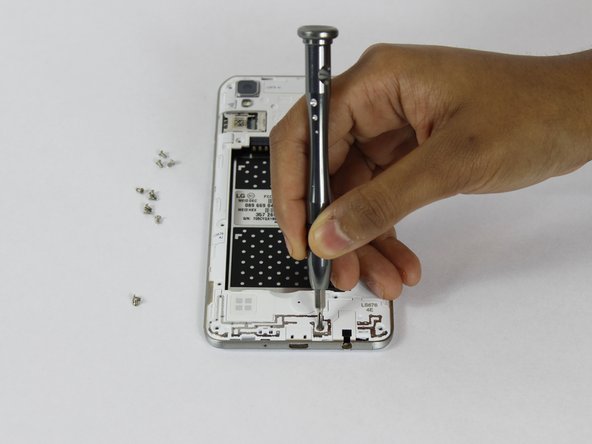

    • Remove the twelve 2mm JIS #00 screws from the mid-frame.

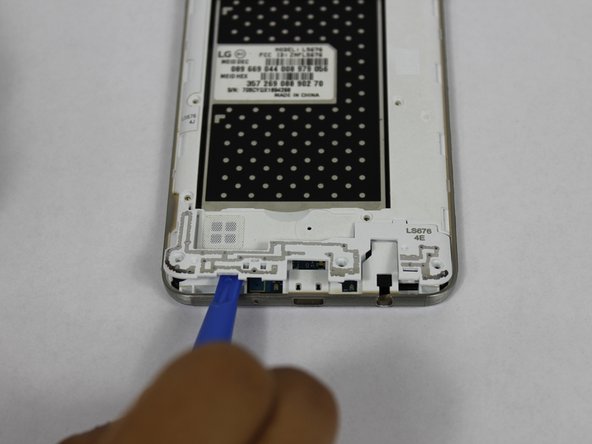

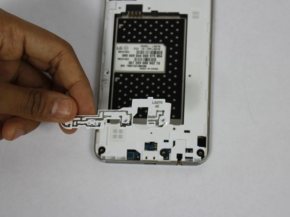

    • Using a plastic opening tool, remove the antenna extender from the bottom.
  5. LG Tribute HD Flex Cable Replacement: crwdns2935265:05crwdnd2935265:01crwdnd2935265:02crwdne2935265:0 LG Tribute HD Flex Cable Replacement: crwdns2935265:05crwdnd2935265:02crwdnd2935265:02crwdne2935265:0

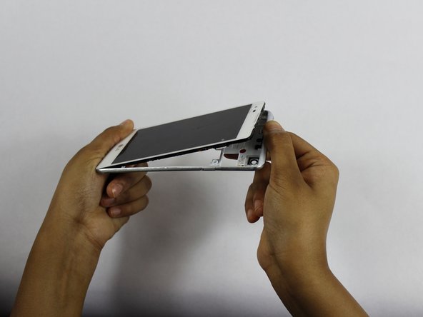

    • Using your fingers, remove the mid-frame.

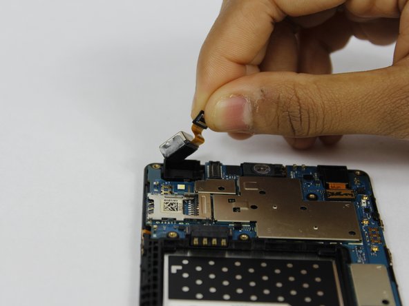

  6. LG Tribute HD Flex Cable Replacement: crwdns2935265:06crwdnd2935265:01crwdnd2935265:03crwdne2935265:0 LG Tribute HD Flex Cable Replacement: crwdns2935265:06crwdnd2935265:02crwdnd2935265:03crwdne2935265:0 LG Tribute HD Flex Cable Replacement: crwdns2935265:06crwdnd2935265:03crwdnd2935265:03crwdne2935265:0

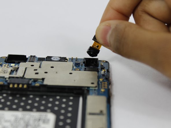

    • Use a plastic opening tool to disconnect the front and rear cameras from the motherboard.
    • Remove the cameras from the phone.

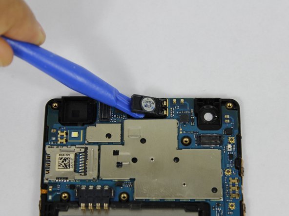

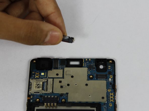

  7. LG Tribute HD Flex Cable Replacement: crwdns2935265:07crwdnd2935265:01crwdnd2935265:03crwdne2935265:0 LG Tribute HD Flex Cable Replacement: crwdns2935265:07crwdnd2935265:02crwdnd2935265:03crwdne2935265:0 LG Tribute HD Flex Cable Replacement: crwdns2935265:07crwdnd2935265:03crwdnd2935265:03crwdne2935265:0
    • Using a plastic opening tool, pry up the front facing speaker and remove it from the phone.

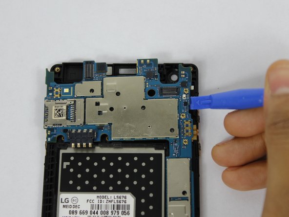

  9. LG Tribute HD Flex Cable Replacement: crwdns2935265:09crwdnd2935265:01crwdnd2935265:02crwdne2935265:0 LG Tribute HD Flex Cable Replacement: crwdns2935265:09crwdnd2935265:02crwdnd2935265:02crwdne2935265:0
    • Use a plastic opening tool to pry up the motherboard form the display housing.
    • Remove the motherboard from the phone.

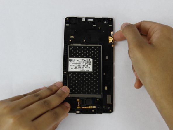

  10. LG Tribute HD Flex Cable Replacement: crwdns2935265:010crwdnd2935265:01crwdnd2935265:02crwdne2935265:0 LG Tribute HD Flex Cable Replacement: crwdns2935265:010crwdnd2935265:02crwdnd2935265:02crwdne2935265:0
    • Use your fingers to remove the flex cables from the phone.
