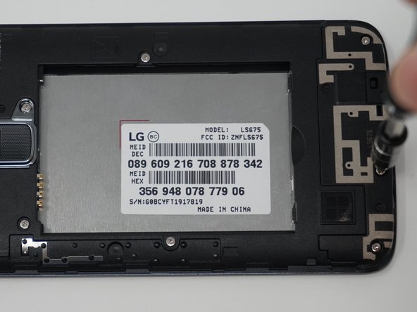

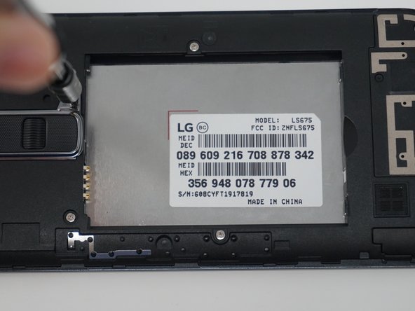

    • Remove the nine 2mm JIS #00 screws from the mid-frame.

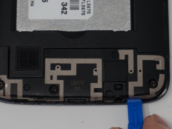

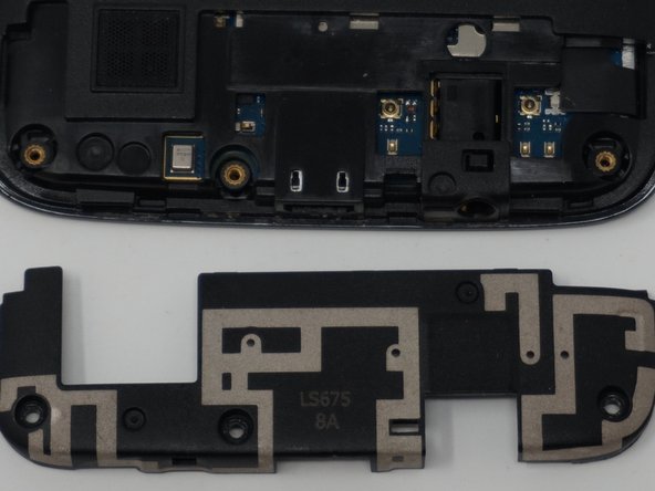

    • Using an iFixit opening tool, remove the antenna extender located at the bottom.

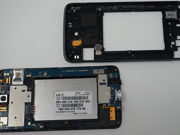

    • Gently remove the mid-frame using an iFixit opening tool.
    • Avoid applying too much force when separating the mid frame. Too much force can bend or damage the device.
