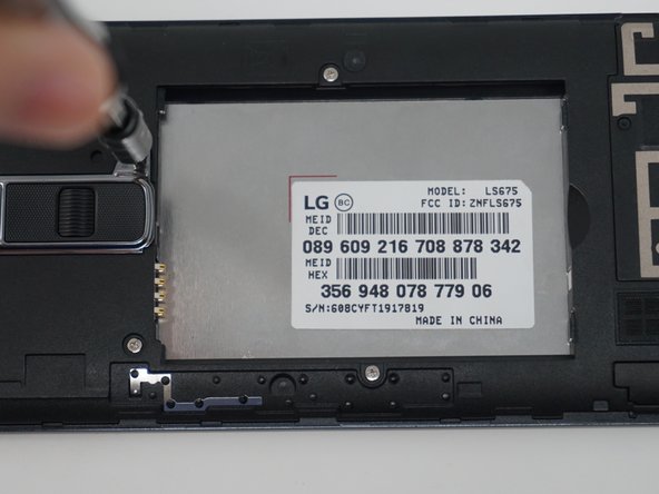

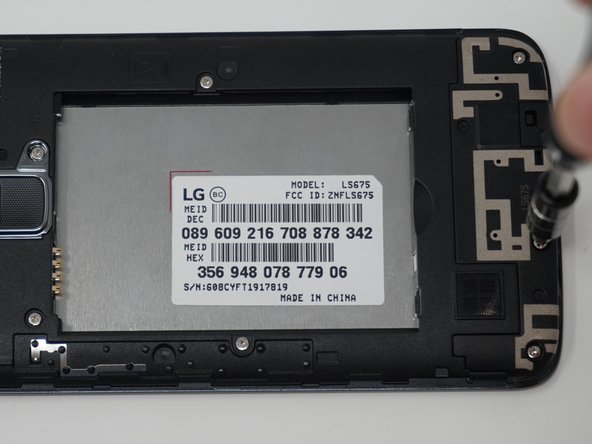

  3. LG Tribute 5 Motherboard Replacement, Motherboard: crwdns2935265:03crwdnd2935265:01crwdnd2935265:03crwdne2935265:0 LG Tribute 5 Motherboard Replacement, Motherboard: crwdns2935265:03crwdnd2935265:02crwdnd2935265:03crwdne2935265:0 LG Tribute 5 Motherboard Replacement, Motherboard: crwdns2935265:03crwdnd2935265:03crwdnd2935265:03crwdne2935265:0
    • Remove the nine 2mm JIS #00 screws from the mid-frame.

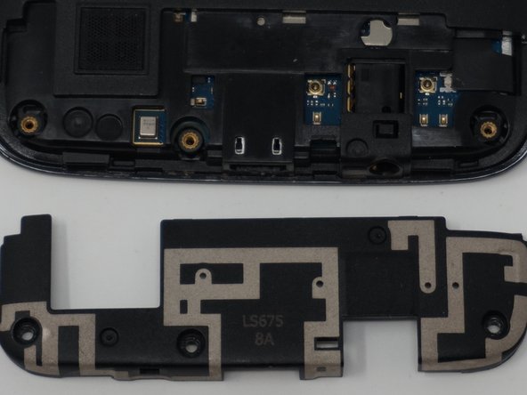

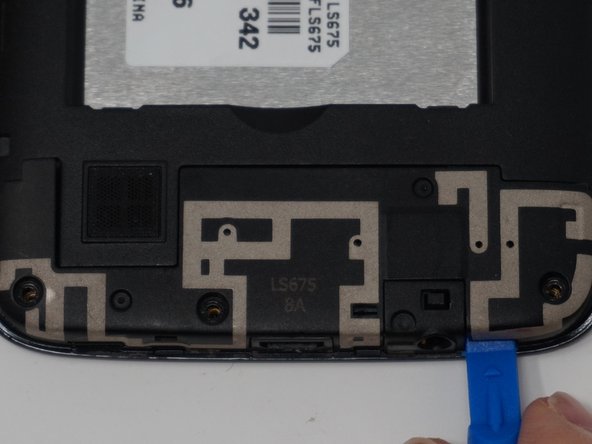

  4. LG Tribute 5 Motherboard Replacement: crwdns2935265:04crwdnd2935265:01crwdnd2935265:03crwdne2935265:0 LG Tribute 5 Motherboard Replacement: crwdns2935265:04crwdnd2935265:02crwdnd2935265:03crwdne2935265:0 LG Tribute 5 Motherboard Replacement: crwdns2935265:04crwdnd2935265:03crwdnd2935265:03crwdne2935265:0
    • Using an iFixit opening tool, remove the antenna extender located at the bottom.

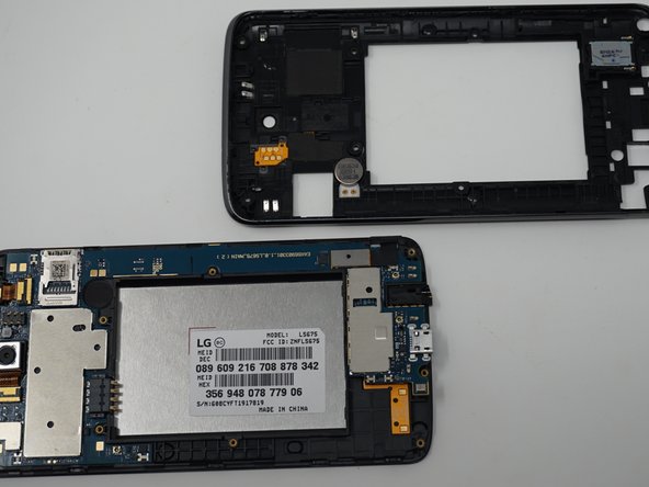

  5. LG Tribute 5 Motherboard Replacement: crwdns2935265:05crwdnd2935265:01crwdnd2935265:02crwdne2935265:0 LG Tribute 5 Motherboard Replacement: crwdns2935265:05crwdnd2935265:02crwdnd2935265:02crwdne2935265:0
    • Gently remove the mid-frame using an iFixit opening tool as shown.
    • Avoid applying too much force when separating the mid frame. Too much force can bend or damage the device.

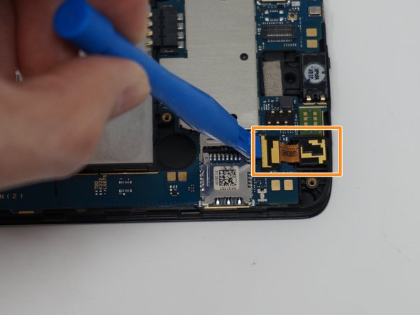

  6. LG Tribute 5 Motherboard Replacement: crwdns2935265:06crwdnd2935265:01crwdnd2935265:02crwdne2935265:0 LG Tribute 5 Motherboard Replacement: crwdns2935265:06crwdnd2935265:02crwdnd2935265:02crwdne2935265:0
    • Using an iFixit opening tool, gently disconnect the rear camera from the top center of the motherboard.
    • Remove the front facing camera from the top right corner of the motherboard.
