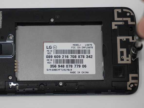

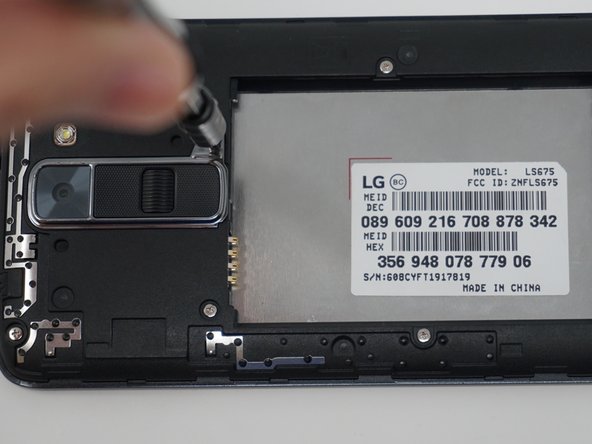

    1. LG Tribute 5 Display Replacement, Display: crwdns2935265:03crwdnd2935265:01crwdnd2935265:03crwdne2935265:0 LG Tribute 5 Display Replacement, Display: crwdns2935265:03crwdnd2935265:02crwdnd2935265:03crwdne2935265:0 LG Tribute 5 Display Replacement, Display: crwdns2935265:03crwdnd2935265:03crwdnd2935265:03crwdne2935265:0
      • Remove the nine 2mm JIS #00 screws from the mid-frame.

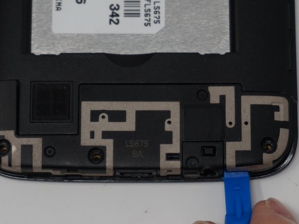

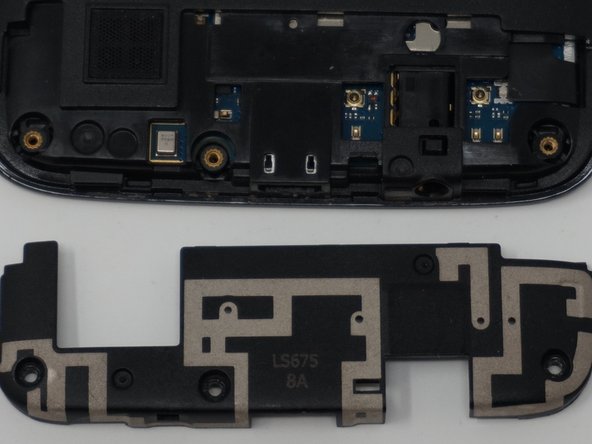

    2. LG Tribute 5 Display Replacement: crwdns2935265:04crwdnd2935265:01crwdnd2935265:03crwdne2935265:0 LG Tribute 5 Display Replacement: crwdns2935265:04crwdnd2935265:02crwdnd2935265:03crwdne2935265:0 LG Tribute 5 Display Replacement: crwdns2935265:04crwdnd2935265:03crwdnd2935265:03crwdne2935265:0
      • Using an iFixit opening tool, remove the antenna extender located at the bottom.

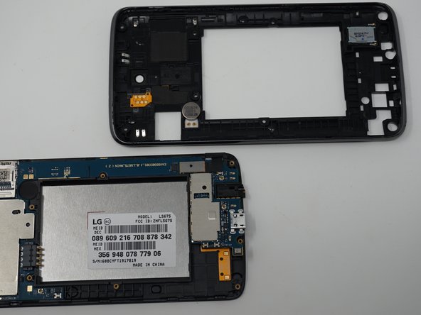

    3. LG Tribute 5 Display Replacement: crwdns2935265:05crwdnd2935265:01crwdnd2935265:02crwdne2935265:0 LG Tribute 5 Display Replacement: crwdns2935265:05crwdnd2935265:02crwdnd2935265:02crwdne2935265:0
      • Gently remove the mid-frame using an iFixit opening tool as shown.
      • Avoid applying too much force when separating the mid frame. Too much force can bend or damage the device.

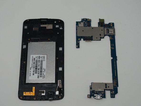

    4. LG Tribute 5 Display Replacement: crwdns2935265:06crwdnd2935265:01crwdnd2935265:01crwdne2935265:0
      • Disconnect the flex cable from the motherboard with the iFixit opening tool.
    5. LG Tribute 5 Display Replacement: crwdns2935265:07crwdnd2935265:01crwdnd2935265:02crwdne2935265:0 LG Tribute 5 Display Replacement: crwdns2935265:07crwdnd2935265:02crwdnd2935265:02crwdne2935265:0
      • Use an iFixit opening tool to separate the motherboard and the display.
