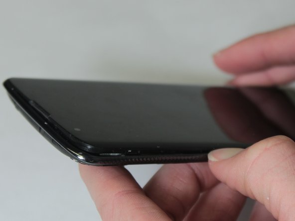

    1. LG Treasure Rear Camera Replacement, Battery: crwdns2935265:01crwdnd2935265:01crwdnd2935265:02crwdne2935265:0 LG Treasure Rear Camera Replacement, Battery: crwdns2935265:01crwdnd2935265:02crwdnd2935265:02crwdne2935265:0
      • Make sure the LG Treasure is turned off.
      • Pull off the back cover from the phone using the groove on the bottom right side.
    2. LG Treasure Rear Camera Replacement: crwdns2935265:02crwdnd2935265:01crwdnd2935265:01crwdne2935265:0
      • Remove the battery from the phone by lifting up on the bottom end of the battery.

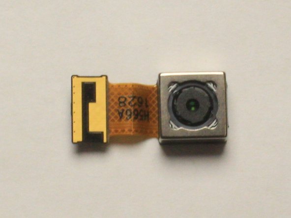

    1. LG Treasure Rear Camera Replacement, Rear Camera: crwdns2935265:03crwdnd2935265:01crwdnd2935265:02crwdne2935265:0 LG Treasure Rear Camera Replacement, Rear Camera: crwdns2935265:03crwdnd2935265:02crwdnd2935265:02crwdne2935265:0
      • Remove all 9 of the 3 mm Phillips #000 screws from the digitizer.
      • Work your way around the edge of the phone, gently prying the digitizer off the phone.
    2. LG Treasure Rear Camera Replacement: crwdns2935265:04crwdnd2935265:01crwdnd2935265:02crwdne2935265:0 LG Treasure Rear Camera Replacement: crwdns2935265:04crwdnd2935265:02crwdnd2935265:02crwdne2935265:0
      • Pull up on the gold film-like connector which is to the left side of camera. Once you have pulled the connector loose you can then gently lift the rear camera out of the phone.
