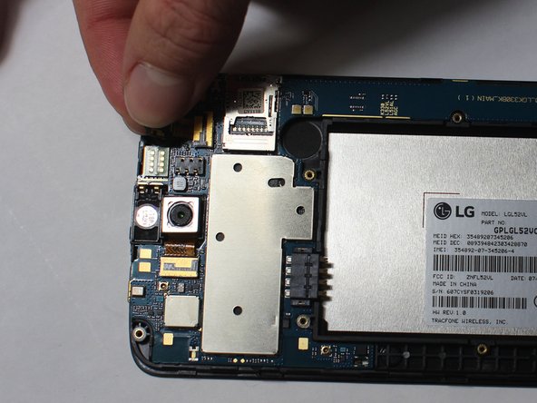

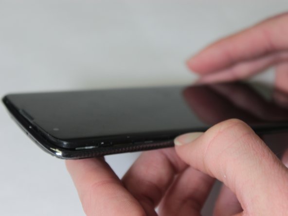

    1. LG Treasure Display Replacement, Display: crwdns2935265:03crwdnd2935265:01crwdnd2935265:02crwdne2935265:0 LG Treasure Display Replacement, Display: crwdns2935265:03crwdnd2935265:02crwdnd2935265:02crwdne2935265:0
      • Remove all 9 of the 3mm Phillips #000 screws from the digitizer.
      • Work your way around the edge of the phone, gently prying the digitizer off the phone.
    2. LG Treasure Display Replacement: crwdns2935265:04crwdnd2935265:01crwdnd2935265:03crwdne2935265:0 LG Treasure Display Replacement: crwdns2935265:04crwdnd2935265:02crwdnd2935265:03crwdne2935265:0 LG Treasure Display Replacement: crwdns2935265:04crwdnd2935265:03crwdnd2935265:03crwdne2935265:0

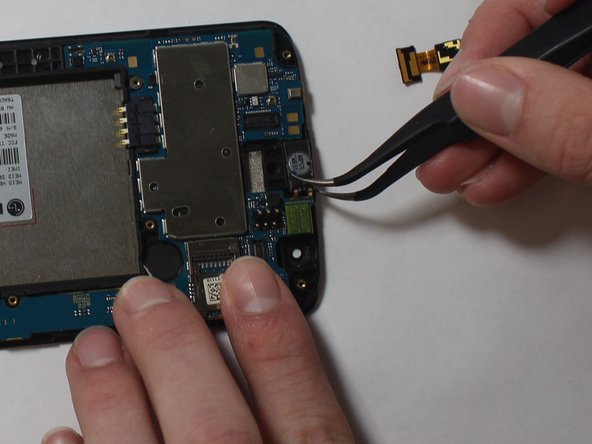

      • Remove the Front Facing Camera, Rear Facing Camera, and the Display Connector by lifting the gold film-like connectors out of their connections.
      • Remove the ear speaker and audio jack by lifting them out of place using the tweezers.

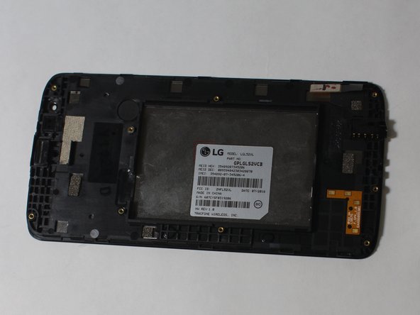

    3. LG Treasure Display Replacement: crwdns2935265:05crwdnd2935265:01crwdnd2935265:02crwdne2935265:0 LG Treasure Display Replacement: crwdns2935265:05crwdnd2935265:02crwdnd2935265:02crwdne2935265:0
      • Remove the motherboard from the display screen by lifting it out of place.
