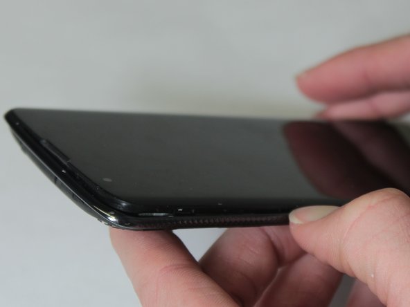

    • Remove all 9 of the 3mm Phillips #000 screws from the digitizer.
    • Work your way around the edge of the phone, gently prying the digitizer off the phone.

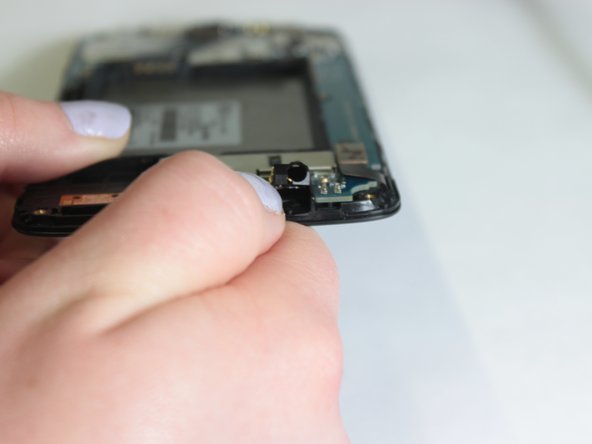

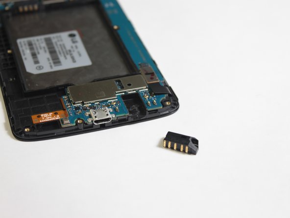

  4. LG Treasure Auxiliary Port Replacement: crwdns2935265:04crwdnd2935265:01crwdnd2935265:03crwdne2935265:0 LG Treasure Auxiliary Port Replacement: crwdns2935265:04crwdnd2935265:02crwdnd2935265:03crwdne2935265:0 LG Treasure Auxiliary Port Replacement: crwdns2935265:04crwdnd2935265:03crwdnd2935265:03crwdne2935265:0
    • Insert your finger nail into the groove under the Auxiliary Port and pry the Auxiliary Port out.
