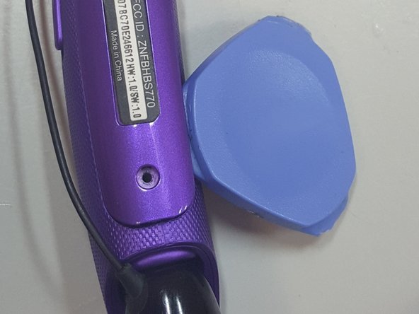

    • There are 2 hidden screws that need to be removed.
    • Remove the rubber covering that covers the hidden screws.
  2. LG Tone Pro HBS-770 Speaker Replacement, Remove Hidden Screws: crwdns2935265:02crwdnd2935265:01crwdnd2935265:02crwdne2935265:0 LG Tone Pro HBS-770 Speaker Replacement, Remove Hidden Screws: crwdns2935265:02crwdnd2935265:02crwdnd2935265:02crwdne2935265:0
    • Remove both of the hidden screws using a Philips #00 screwdriver.

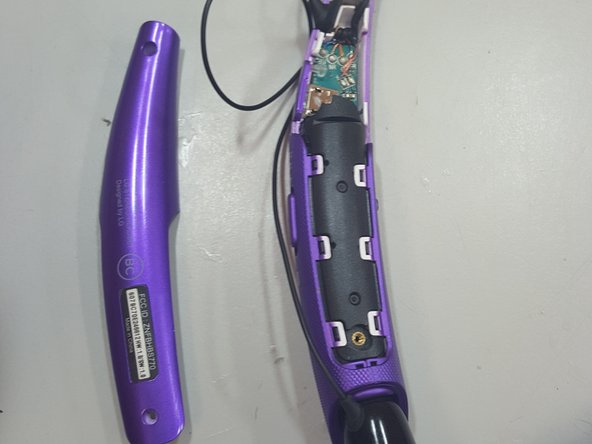

  3. LG Tone Pro HBS-770 Speaker Replacement, Pry Open Housing: crwdns2935265:03crwdnd2935265:01crwdnd2935265:03crwdne2935265:0 LG Tone Pro HBS-770 Speaker Replacement, Pry Open Housing: crwdns2935265:03crwdnd2935265:02crwdnd2935265:03crwdne2935265:0 LG Tone Pro HBS-770 Speaker Replacement, Pry Open Housing: crwdns2935265:03crwdnd2935265:03crwdnd2935265:03crwdne2935265:0
    • Use a guitar pick or any pry opening tool to open the housing.
  4. LG Tone Pro HBS-770 Speaker Replacement, Remove Speaker: crwdns2935265:04crwdnd2935265:01crwdnd2935265:01crwdne2935265:0
    • Desolder speaker connection from board using a solder iron.
