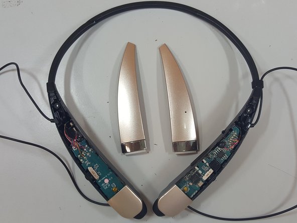

    • Locate the right and left side speaker where the hidden screw is located and remove the rubber piece covering the screw.
  2. LG Tone Pro HBS-760 Speaker  Replacement, Remove Hidden Screw: crwdns2935265:02crwdnd2935265:01crwdnd2935265:02crwdne2935265:0 LG Tone Pro HBS-760 Speaker  Replacement, Remove Hidden Screw: crwdns2935265:02crwdnd2935265:02crwdnd2935265:02crwdne2935265:0
    • Using a Philips #00 screwdriver, remove the hidden screws from both sides.

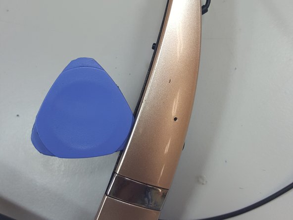

  3. LG Tone Pro HBS-760 Speaker  Replacement, Pry Open Housing: crwdns2935265:03crwdnd2935265:01crwdnd2935265:03crwdne2935265:0 LG Tone Pro HBS-760 Speaker  Replacement, Pry Open Housing: crwdns2935265:03crwdnd2935265:02crwdnd2935265:03crwdne2935265:0 LG Tone Pro HBS-760 Speaker  Replacement, Pry Open Housing: crwdns2935265:03crwdnd2935265:03crwdnd2935265:03crwdne2935265:0
    • Use a guitar pick or any opening tool to pry open the housing for the side you want to replace the speaker.

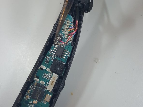

  4. LG Tone Pro HBS-760 Speaker  Replacement, Desolder Speaker: crwdns2935265:04crwdnd2935265:01crwdnd2935265:03crwdne2935265:0 LG Tone Pro HBS-760 Speaker  Replacement, Desolder Speaker: crwdns2935265:04crwdnd2935265:02crwdnd2935265:03crwdne2935265:0 LG Tone Pro HBS-760 Speaker  Replacement, Desolder Speaker: crwdns2935265:04crwdnd2935265:03crwdnd2935265:03crwdne2935265:0
    • Right side can be de-soldered right away but the left side speaker solder connection to the board is covered by rubber material which needs to be removed first before it can be de-soldered.
