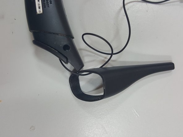

    • Locate the hidden screw as seen in the picture and remove the rubber covering the screw.
  2. LG Tone Active HBS-850 Speaker Replacement, Remove Hidden Screw: crwdns2935265:02crwdnd2935265:01crwdnd2935265:01crwdne2935265:0
    • Remove hidden screw using a Philips #00 screwdriver.

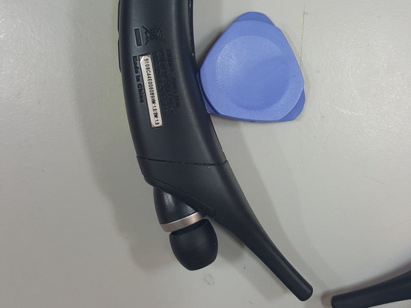

  3. LG Tone Active HBS-850 Speaker Replacement, Pry Open Speaker Housing: crwdns2935265:03crwdnd2935265:01crwdnd2935265:02crwdne2935265:0 LG Tone Active HBS-850 Speaker Replacement, Pry Open Speaker Housing: crwdns2935265:03crwdnd2935265:02crwdnd2935265:02crwdne2935265:0
    • Use a guitar pick or any pry opening tool to gently lift the housing until the speaker end. There is a hidden screw that needs to be removed before the housing can be completely removed.

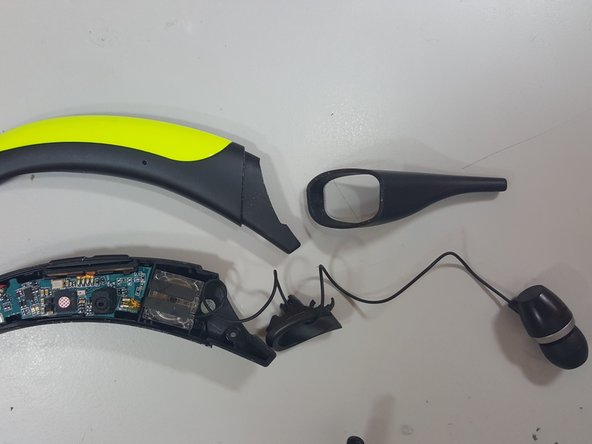

  4. LG Tone Active HBS-850 Speaker Replacement, Locate Hidden Speaker Screw: crwdns2935265:04crwdnd2935265:01crwdnd2935265:02crwdne2935265:0 LG Tone Active HBS-850 Speaker Replacement, Locate Hidden Speaker Screw: crwdns2935265:04crwdnd2935265:02crwdnd2935265:02crwdne2935265:0
    • Gently remove the pointy rubber covering using tweezers where the speaker rests as shown in the picture.
  5. LG Tone Active HBS-850 Speaker Replacement, Remove Hidden Speaker Screw: crwdns2935265:05crwdnd2935265:01crwdnd2935265:02crwdne2935265:0 LG Tone Active HBS-850 Speaker Replacement, Remove Hidden Speaker Screw: crwdns2935265:05crwdnd2935265:02crwdnd2935265:02crwdne2935265:0
    • Use a Philips #00 screwdriver to remove the hidden screw.
  6. LG Tone Active HBS-850 Speaker Replacement, Remove Speaker Screw: crwdns2935265:06crwdnd2935265:01crwdnd2935265:01crwdne2935265:0
    • Remove the screw holding the speaker in place using a Philips #00 screwdriver.
  7. LG Tone Active HBS-850 Speaker Replacement, Desolder Speaker: crwdns2935265:07crwdnd2935265:01crwdnd2935265:02crwdne2935265:0 LG Tone Active HBS-850 Speaker Replacement, Desolder Speaker: crwdns2935265:07crwdnd2935265:02crwdnd2935265:02crwdne2935265:0
    • Desolder speaker connection using a soldering iron and replace with new speaker.
