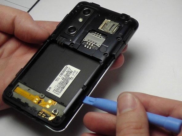

      • Pry open the back cover by using a fingernail or a plastic opening tool.
      • There is a small notch at the bottom of the cover for easy removal.

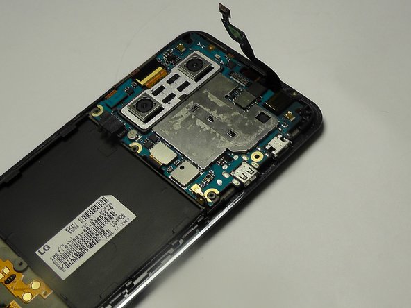

    1. LG Thrill 4G SIM/Micro SD Card Replacement, Screw Removal: crwdns2935265:03crwdnd2935265:01crwdnd2935265:01crwdne2935265:0
      • Remove the three Philips #00 screws from the bottom of the phone.
      • Two 5.5 mm screws
      • One 4 mm screw

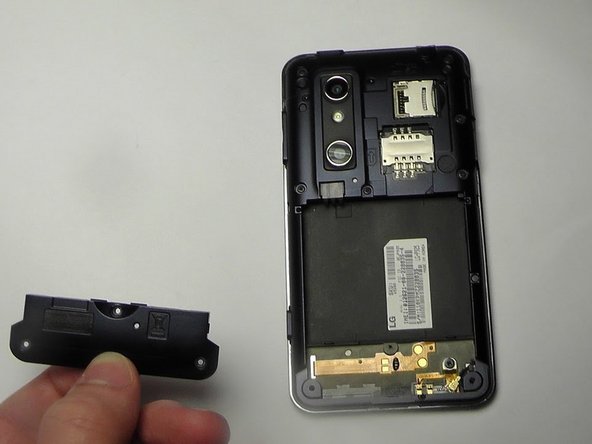

    2. LG Thrill 4G SIM/Micro SD Card Replacement, Speaker Removal: crwdns2935265:04crwdnd2935265:01crwdnd2935265:02crwdne2935265:0 LG Thrill 4G SIM/Micro SD Card Replacement, Speaker Removal: crwdns2935265:04crwdnd2935265:02crwdnd2935265:02crwdne2935265:0
      • Use your finger or opening tool to wedge the speaker out starting at the small notch at the bottom of the phone.

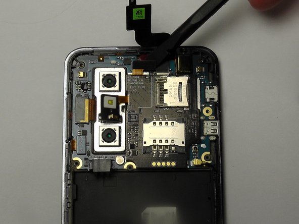

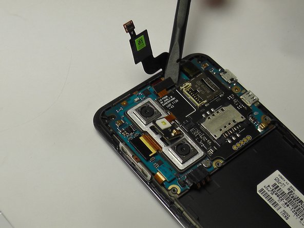

    1. LG Thrill 4G SIM/Micro SD Card Replacement, Ribbon Cable Disconnection: crwdns2935265:08crwdnd2935265:01crwdnd2935265:03crwdne2935265:0 LG Thrill 4G SIM/Micro SD Card Replacement, Ribbon Cable Disconnection: crwdns2935265:08crwdnd2935265:02crwdnd2935265:03crwdne2935265:0 LG Thrill 4G SIM/Micro SD Card Replacement, Ribbon Cable Disconnection: crwdns2935265:08crwdnd2935265:03crwdnd2935265:03crwdne2935265:0
      • Utilize a spudger or plastic opening tool and gently disconnect the ribbon cable that is attached to the black micro-SIM card board.

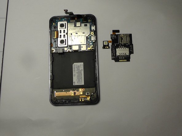

    2. LG Thrill 4G SIM/Micro SD Card Replacement, SD/SIM Card Board Removal: crwdns2935265:09crwdnd2935265:01crwdnd2935265:03crwdne2935265:0 LG Thrill 4G SIM/Micro SD Card Replacement, SD/SIM Card Board Removal: crwdns2935265:09crwdnd2935265:02crwdnd2935265:03crwdne2935265:0 LG Thrill 4G SIM/Micro SD Card Replacement, SD/SIM Card Board Removal: crwdns2935265:09crwdnd2935265:03crwdnd2935265:03crwdne2935265:0
      • Carefully pry the board up to detach it from its place in the phone.
      • Make sure to pry off the small tab connected to the camera unit as well.
