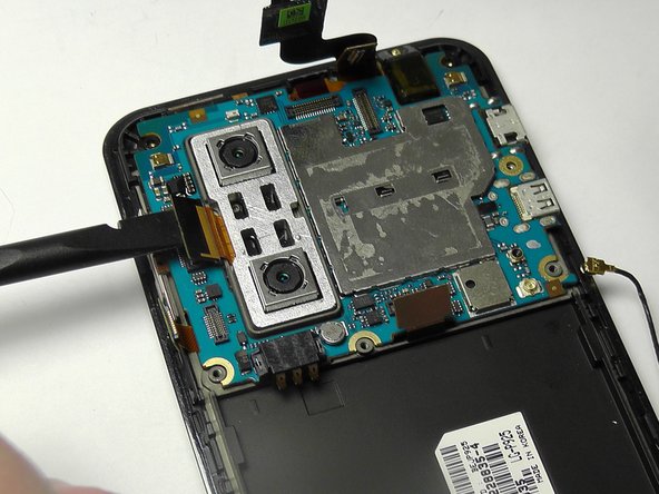

  8. LG Thrill 4G Motherboard Replacement, Ribbon Cable Disconnection: crwdns2935265:08crwdnd2935265:01crwdnd2935265:03crwdne2935265:0 LG Thrill 4G Motherboard Replacement, Ribbon Cable Disconnection: crwdns2935265:08crwdnd2935265:02crwdnd2935265:03crwdne2935265:0 LG Thrill 4G Motherboard Replacement, Ribbon Cable Disconnection: crwdns2935265:08crwdnd2935265:03crwdnd2935265:03crwdne2935265:0
    • Utilize a spudger or plastic opening tool and gently disconnect the ribbon cable that is attached to the black micro-SIM card board.

  10. LG Thrill 4G Motherboard Replacement, Motherboard: crwdns2935265:010crwdnd2935265:01crwdnd2935265:02crwdne2935265:0 LG Thrill 4G Motherboard Replacement, Motherboard: crwdns2935265:010crwdnd2935265:02crwdnd2935265:02crwdne2935265:0
    • Use a plastic opening tool or spudger to gently disconnect the ribbon cables connected to the motherboard.
    • Disconnect the antenna cable from the bottom right corner of the motherboard.

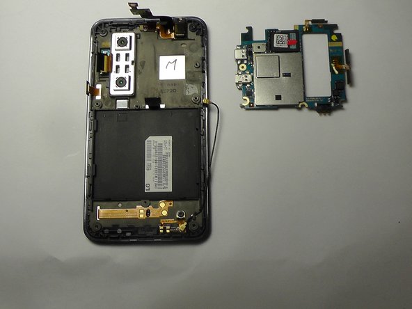

  11. LG Thrill 4G Motherboard Replacement: crwdns2935265:011crwdnd2935265:01crwdnd2935265:02crwdne2935265:0 LG Thrill 4G Motherboard Replacement: crwdns2935265:011crwdnd2935265:02crwdnd2935265:02crwdne2935265:0
    • Use a spudger or pair of tweezers to grab the top left corner of the motherboard and gently lift it out, taking care to not damage any of the ribbon cables when removing.
