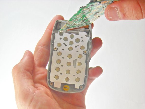

  10. LG TP 1100 Microphone Replacement: crwdns2935265:010crwdnd2935265:01crwdnd2935265:02crwdne2935265:0 LG TP 1100 Microphone Replacement: crwdns2935265:010crwdnd2935265:02crwdnd2935265:02crwdne2935265:0
    • Rotate the phone so that the circuit board is in the palm of your hand and the part connected with tape hangs behind.
    • Use your opening tool to pry the circuit board from the front cover. Do not let the number pad to fall out.
  11. LG TP 1100 Microphone Replacement: crwdns2935265:011crwdnd2935265:01crwdnd2935265:01crwdne2935265:0
    • To remove the microphone, insert your opening tool under microphone and push upward to pry microphone away from the front cover.
