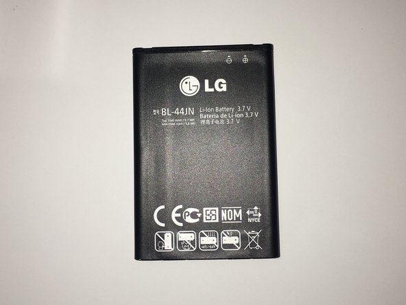

  4. LG Sunrise Midframe Replacement, Battery: crwdns2935265:04crwdnd2935265:01crwdnd2935265:02crwdne2935265:0 LG Sunrise Midframe Replacement, Battery: crwdns2935265:04crwdnd2935265:02crwdnd2935265:02crwdne2935265:0
    • Use your finger to pull out battery from the bottom of the device.

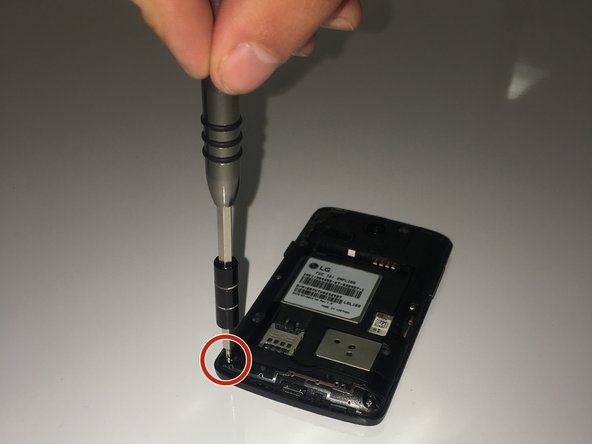

  5. crwdns2944590:05crwdnd2944590:06crwdnd2944590:0crwdnd2944590:0crwdne2944590:0

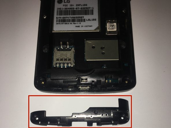

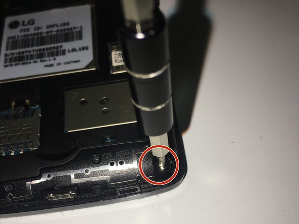

    LG Sunrise Midframe Replacement, Lower Back Plastic Piece: crwdns2935265:05crwdnd2935265:01crwdnd2935265:03crwdne2935265:0 LG Sunrise Midframe Replacement, Lower Back Plastic Piece: crwdns2935265:05crwdnd2935265:02crwdnd2935265:03crwdne2935265:0 LG Sunrise Midframe Replacement, Lower Back Plastic Piece: crwdns2935265:05crwdnd2935265:03crwdnd2935265:03crwdne2935265:0

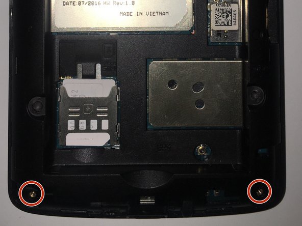

    • You will be first removing the two lower screws. This is allow you to remove the lower plastic piece.
  6. LG Sunrise Midframe Replacement: crwdns2935265:06crwdnd2935265:01crwdnd2935265:01crwdne2935265:0
    • Once both of the screws are out you can easily pop off the bottom piece.

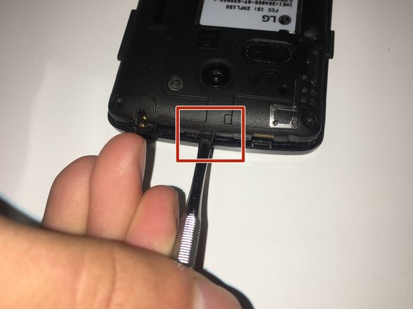

  7. LG Sunrise Midframe Replacement, Midframe: crwdns2935265:07crwdnd2935265:01crwdnd2935265:02crwdne2935265:0 LG Sunrise Midframe Replacement, Midframe: crwdns2935265:07crwdnd2935265:02crwdnd2935265:02crwdne2935265:0
    • Once you have removed all 6 screws. Gently pry all sides of back plastic piece, starting at the bottom. Once you start on the bottom, it will become easier to pry.

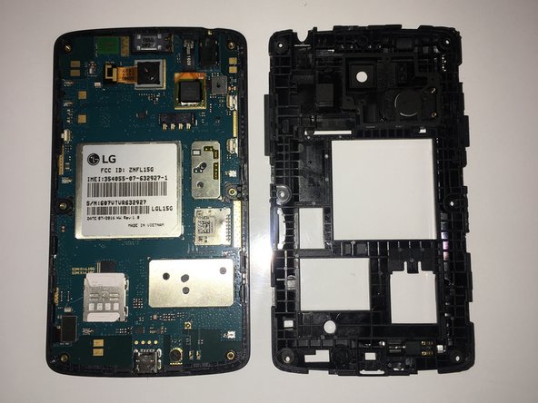

  8. LG Sunrise Midframe Replacement: crwdns2935265:08crwdnd2935265:01crwdnd2935265:02crwdne2935265:0 LG Sunrise Midframe Replacement: crwdns2935265:08crwdnd2935265:02crwdnd2935265:02crwdne2935265:0
    • Once you have pried off the back piece, the mother board should be exposed. Set this piece aside for replacement or reassembly.
