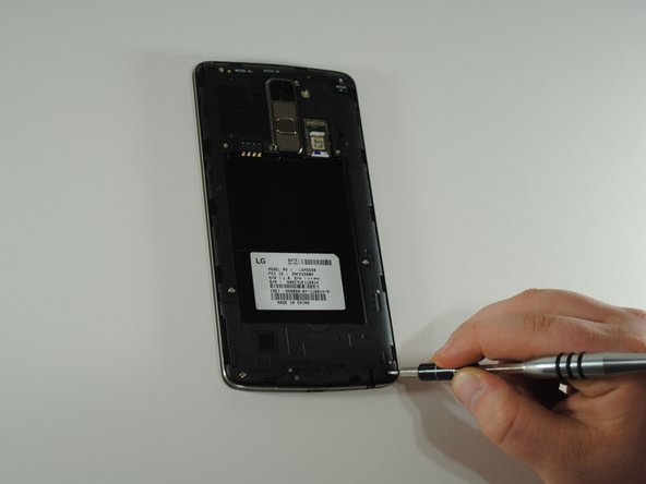

    • To remove the rear case of the phone, insert the spudger into the opening on the back of the case.
    • With the spudger parallel to the frame of the phone, slide it along the edge, forcing the casing to pop off.

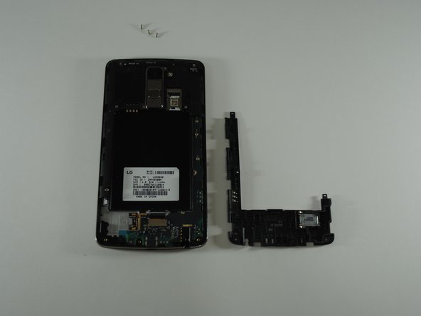

    • Remove the cover from the phone in order to access the speaker.
    • Using the JIS #000 screwdriver, remove the four 4mm screws around the base of the mid-frame.
  4. LG Stylo 2 Plus Speaker Replacement: crwdns2935265:04crwdnd2935265:01crwdnd2935265:02crwdne2935265:0 LG Stylo 2 Plus Speaker Replacement: crwdns2935265:04crwdnd2935265:02crwdnd2935265:02crwdne2935265:0
    • Insert the metal spudger in the dimple at the base of the mid-frame.
    • Pry upward, removing bottom section of the mid-frame from the phone.

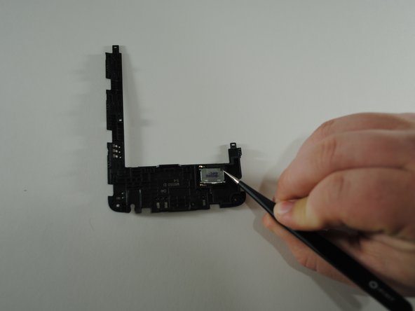

    • Flip the bottom piece of the mid-frame over to show the speaker in the bottom right corner.
    • Using the tweezers, peel back the rubber resting on top of the speaker.

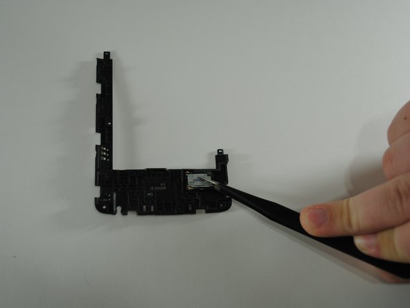

    • Still using the tweezers, grasp the speaker unit and remove it from the mid-frame.
