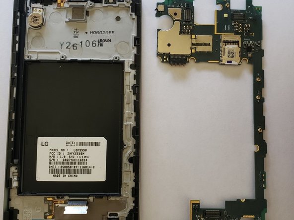

    5. LG Stylo 2 Plus Screen Replacement: crwdns2935265:09crwdnd2935265:01crwdnd2935265:01crwdne2935265:0
      • To prepare the phone for heat you need to remove the audio jack.
      • This can be done using tweezers or fingers, and prying upwards.

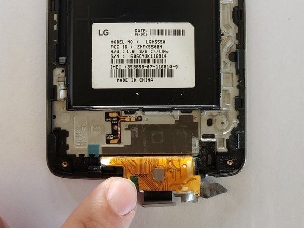

    8. LG Stylo 2 Plus Screen Replacement: crwdns2935265:012crwdnd2935265:01crwdnd2935265:03crwdne2935265:0 LG Stylo 2 Plus Screen Replacement: crwdns2935265:012crwdnd2935265:02crwdnd2935265:03crwdne2935265:0 LG Stylo 2 Plus Screen Replacement: crwdns2935265:012crwdnd2935265:03crwdnd2935265:03crwdne2935265:0
      • Using tweezers, gently pull upwards on one edge of the adhesive tape.
      • Carefully pull the tape back until the whole ribbon cable is exposed.

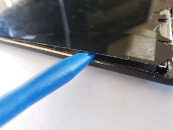

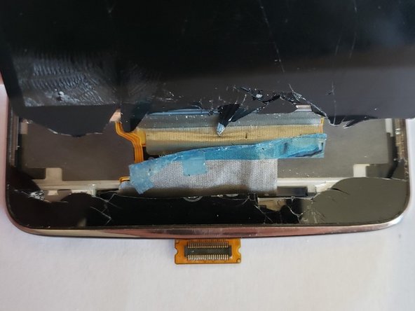

    9. LG Stylo 2 Plus Screen Replacement: crwdns2935265:013crwdnd2935265:01crwdnd2935265:03crwdne2935265:0 LG Stylo 2 Plus Screen Replacement: crwdns2935265:013crwdnd2935265:02crwdnd2935265:03crwdne2935265:0 LG Stylo 2 Plus Screen Replacement: crwdns2935265:013crwdnd2935265:03crwdnd2935265:03crwdne2935265:0
      • Remember to put on your safety glasses if you have not already. Glass, and shattered glass especially, can be dangerous if proper eye protection is not worn.
      • Briefly run the heat gun on a low setting around the outside edge of the screen to warm up the adhesive keeping the phone in place.
      • Keep heat gun on a low setting, and keep the point you are heating moving. Do not hold the heat gun in one spot for long.
      • Work an iFixit opening tool under the lip of the screen and pry upwards carefully.
      • Once you are able to work the screen up around the edge of the device, pull the ribbon cable out of the phone through the thin slot at the bottom of the phone.
