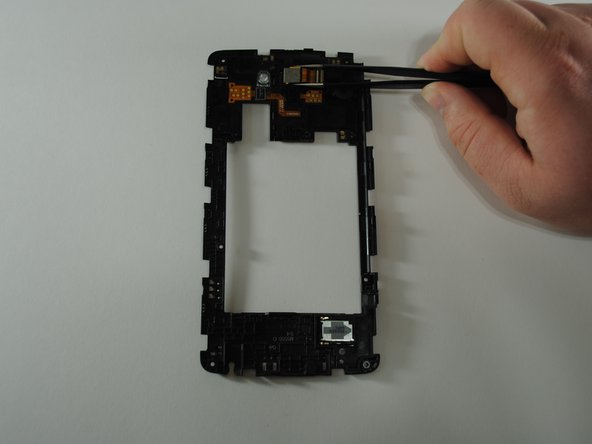

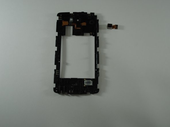

    1. LG Stylo 2 Plus Rear Camera Replacement, Rear Camera: crwdns2935265:05crwdnd2935265:01crwdnd2935265:03crwdne2935265:0 LG Stylo 2 Plus Rear Camera Replacement, Rear Camera: crwdns2935265:05crwdnd2935265:02crwdnd2935265:03crwdne2935265:0 LG Stylo 2 Plus Rear Camera Replacement, Rear Camera: crwdns2935265:05crwdnd2935265:03crwdnd2935265:03crwdne2935265:0
      • Flip the cover over to show the rear camera unit in the center of the cover.
      • Using the tweezers, carefully grab the rear camera unit and pull directly upward, removing the unit from the cover housing.
