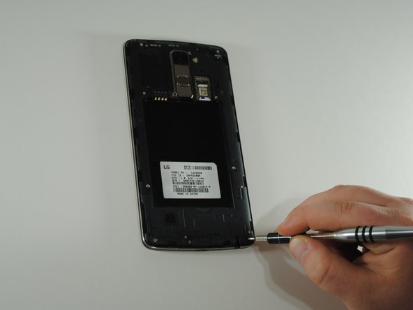

    1. LG Stylo 2 Plus Front Camera Replacement, Rear Case: crwdns2935265:01crwdnd2935265:01crwdnd2935265:03crwdne2935265:0 LG Stylo 2 Plus Front Camera Replacement, Rear Case: crwdns2935265:01crwdnd2935265:02crwdnd2935265:03crwdne2935265:0 LG Stylo 2 Plus Front Camera Replacement, Rear Case: crwdns2935265:01crwdnd2935265:03crwdnd2935265:03crwdne2935265:0
      • To remove the rear case of the phone, insert the spudger into the opening on the back of the case.
      • With the spudger parallel to the frame of the phone, slide it along the edge, forcing the casing to pop off.

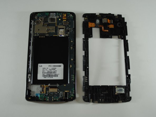

    1. LG Stylo 2 Plus Front Camera Replacement, Mid-Frame: crwdns2935265:03crwdnd2935265:01crwdnd2935265:02crwdne2935265:0 LG Stylo 2 Plus Front Camera Replacement, Mid-Frame: crwdns2935265:03crwdnd2935265:02crwdnd2935265:02crwdne2935265:0
      • Using the JIS #000 screwdriver, remove the eleven 4mm screws around the mid-frame.
    2. LG Stylo 2 Plus Front Camera Replacement: crwdns2935265:04crwdnd2935265:01crwdnd2935265:02crwdne2935265:0 LG Stylo 2 Plus Front Camera Replacement: crwdns2935265:04crwdnd2935265:02crwdnd2935265:02crwdne2935265:0
      • Insert the metal spudger in the dimple at the base of the cover.
      • Pry upward, removing the mid-frame from the phone.

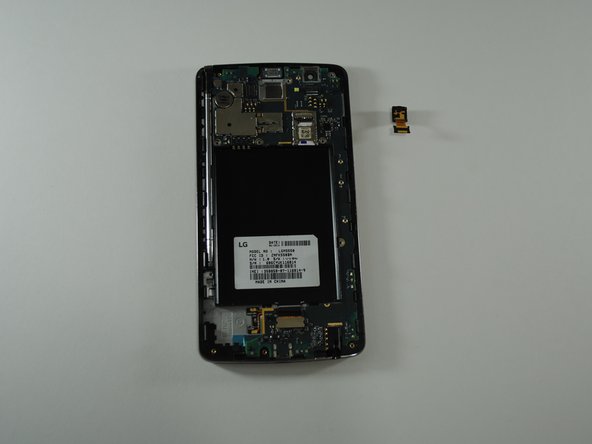

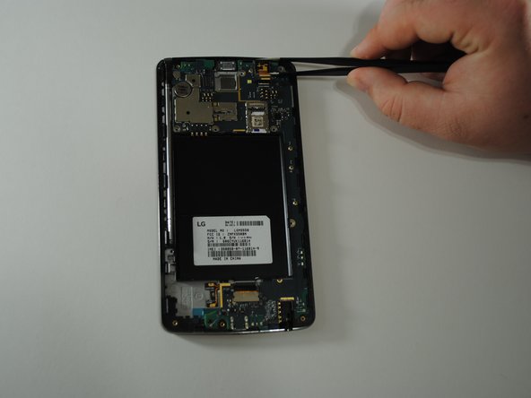

    1. LG Stylo 2 Plus Front Camera Replacement, Front Camera: crwdns2935265:05crwdnd2935265:01crwdnd2935265:03crwdne2935265:0 LG Stylo 2 Plus Front Camera Replacement, Front Camera: crwdns2935265:05crwdnd2935265:02crwdnd2935265:03crwdne2935265:0 LG Stylo 2 Plus Front Camera Replacement, Front Camera: crwdns2935265:05crwdnd2935265:03crwdnd2935265:03crwdne2935265:0
      • Using a pair of tweezers, carefully detach the ribbon cable connecting the camera to the motherboard.
      • Still using the tweezers, firmly pull up to remove the camera from the phone.
