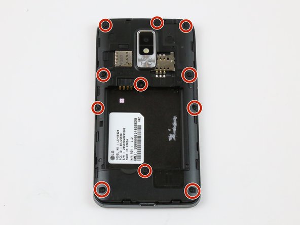

    1. LG Spectrum Camera Replacement, Camera: crwdns2935265:03crwdnd2935265:01crwdnd2935265:02crwdne2935265:0 LG Spectrum Camera Replacement, Camera: crwdns2935265:03crwdnd2935265:02crwdnd2935265:02crwdne2935265:0
      • Remove eleven 4mm Phillips #000 screws with a PH000 screwdriver.
      • Use the magnet board to keep the screws in one place.
    2. LG Spectrum Camera Replacement: crwdns2935265:04crwdnd2935265:01crwdnd2935265:01crwdne2935265:0
      • Use the plastic opening tool to firmly pry up the plastic backing around the perimeter of the phone.

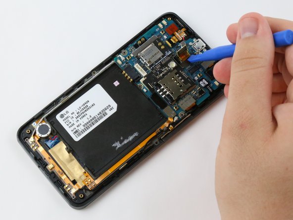

    3. LG Spectrum Camera Replacement: crwdns2935265:05crwdnd2935265:01crwdnd2935265:02crwdne2935265:0 LG Spectrum Camera Replacement: crwdns2935265:05crwdnd2935265:02crwdnd2935265:02crwdne2935265:0
      • Remove the camera by gently lifting the film that is attached to it from motherboard with the plastic opening tool.
    4. LG Spectrum Camera Replacement: crwdns2935265:06crwdnd2935265:01crwdnd2935265:01crwdne2935265:0
      • Use the plastic opening tool, or your hand, to pull up on the camera and remove it from the motherboard.
