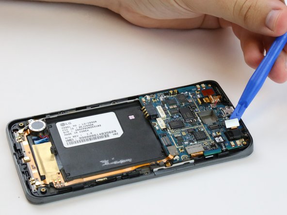

If the audio still skips or doesn't work even after trying to use different headphones then you may need to replace the Audio Jack in the phone. This guide will take you through the necessary steps to accomplish this.
    1. LG Spectrum Audio Port Replacement, Battery: crwdns2935265:01crwdnd2935265:01crwdnd2935265:02crwdne2935265:0 LG Spectrum Audio Port Replacement, Battery: crwdns2935265:01crwdnd2935265:02crwdnd2935265:02crwdne2935265:0
      • Using your thumbnail, lift up on the notch in the middle of the bottom side of the phone.
    2. LG Spectrum Audio Port Replacement: crwdns2935265:02crwdnd2935265:01crwdnd2935265:01crwdne2935265:0
      • Using either your thumbnail or a plastic opening tool, lift up on the battery using the notch in the bottom left hand corner of the battery and remove it from the phone.
    1. LG Spectrum Audio Port Replacement, Audio Port: crwdns2935265:03crwdnd2935265:01crwdnd2935265:02crwdne2935265:0 LG Spectrum Audio Port Replacement, Audio Port: crwdns2935265:03crwdnd2935265:02crwdnd2935265:02crwdne2935265:0
      • Remove eleven 4mm Phillips #000 screws with a PH000 screwdriver.
      • Use the magnet board to keep the screws in one place.
    2. LG Spectrum Audio Port Replacement: crwdns2935265:04crwdnd2935265:01crwdnd2935265:01crwdne2935265:0
      • Use the plastic opening tool to firmly unhinge the plastic backing around the perimeter of the phone.
    3. LG Spectrum Audio Port Replacement: crwdns2935265:05crwdnd2935265:01crwdnd2935265:02crwdne2935265:0 LG Spectrum Audio Port Replacement: crwdns2935265:05crwdnd2935265:02crwdnd2935265:02crwdne2935265:0
      • Using the plastic opening tool, gently pry up the plastic film connecting the audio port to the motherboard.
    4. LG Spectrum Audio Port Replacement: crwdns2935265:06crwdnd2935265:01crwdnd2935265:01crwdne2935265:0
      • Remove the audio port from the motherboard either with your hand or the plastic opening tool.
