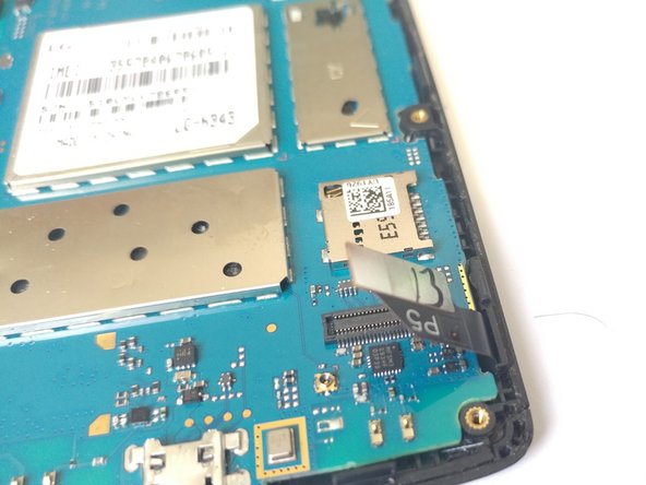

  7. LG Risio Motherboard Replacement, Motherboard: crwdns2935265:07crwdnd2935265:01crwdnd2935265:02crwdne2935265:0 LG Risio Motherboard Replacement, Motherboard: crwdns2935265:07crwdnd2935265:02crwdnd2935265:02crwdne2935265:0
    • Detach the screen connector from the motherboard by putting your thumb underneath it and lifting up.
    • The screen connector is the part that has P5 written on it.
  8. LG Risio Motherboard Replacement: crwdns2935265:08crwdnd2935265:01crwdnd2935265:01crwdne2935265:0
    • On the side with the screen connector, pull the two tabs away from the device.
    • Use the plastic opening tool to lift the motherboard starting on the bottom right corner and pulling upwards.
