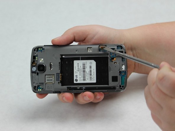

    • Insert the metal spudger into the small groove on the back of the phone.
    • Lift and remove the black plastic covering with the metal spudger.
  3. LG Rebel Motherboard Replacement: crwdns2935265:03crwdnd2935265:01crwdnd2935265:02crwdne2935265:0 LG Rebel Motherboard Replacement: crwdns2935265:03crwdnd2935265:02crwdnd2935265:02crwdne2935265:0
    • Use the metal spudger to lift the remaining black plastic cover pieces.

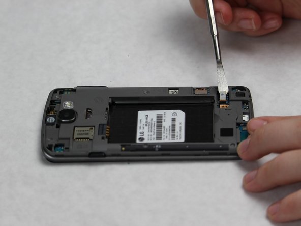

  4. LG Rebel Motherboard Replacement: crwdns2935265:04crwdnd2935265:01crwdnd2935265:03crwdne2935265:0 LG Rebel Motherboard Replacement: crwdns2935265:04crwdnd2935265:02crwdnd2935265:03crwdne2935265:0 LG Rebel Motherboard Replacement: crwdns2935265:04crwdnd2935265:03crwdnd2935265:03crwdne2935265:0
    • Use the metal spudger to lift and disconnect the two connective pieces on the back of the phone.

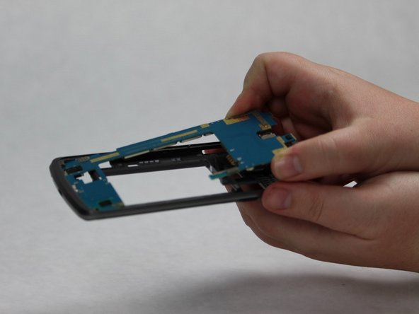

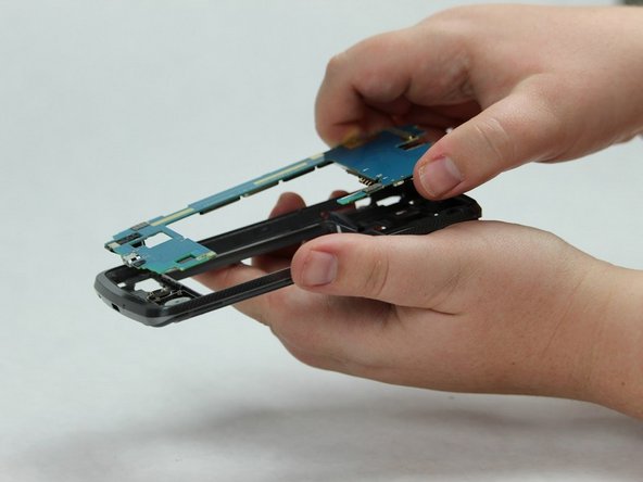

  7. LG Rebel Motherboard Replacement: crwdns2935265:07crwdnd2935265:01crwdnd2935265:03crwdne2935265:0 LG Rebel Motherboard Replacement: crwdns2935265:07crwdnd2935265:02crwdnd2935265:03crwdne2935265:0 LG Rebel Motherboard Replacement: crwdns2935265:07crwdnd2935265:03crwdnd2935265:03crwdne2935265:0
    • Use the metal spudger to carefully loosen the motherboard from the body of the phone.
    • Slowly slide the motherboard out of the body of the phone.
    • Remove the motherboard.
