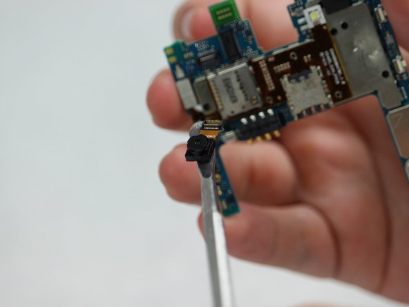

  5. LG Rebel Front Camera Replacement: crwdns2935265:05crwdnd2935265:01crwdnd2935265:03crwdne2935265:0 LG Rebel Front Camera Replacement: crwdns2935265:05crwdnd2935265:02crwdnd2935265:03crwdne2935265:0 LG Rebel Front Camera Replacement: crwdns2935265:05crwdnd2935265:03crwdnd2935265:03crwdne2935265:0
    • Remove the motherboard with a spudger.
    • Slowly begin to lift motherboard with your hand carefully.
    • Once the motherboard is completely off, set the phone to the side and focus on the small black box with a square tail (which is the front camera).
  6. LG Rebel Front Camera Replacement: crwdns2935265:06crwdnd2935265:01crwdnd2935265:02crwdne2935265:0 LG Rebel Front Camera Replacement: crwdns2935265:06crwdnd2935265:02crwdnd2935265:02crwdne2935265:0
    • Remove the front camera by its tail with a spudger.
