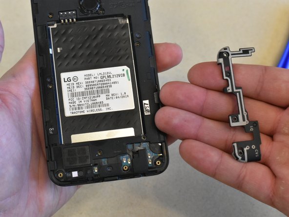

  2. LG Rebel 4 LTE Disassembly, Remove Internal Components: crwdns2935265:02crwdnd2935265:01crwdnd2935265:03crwdne2935265:0 LG Rebel 4 LTE Disassembly, Remove Internal Components: crwdns2935265:02crwdnd2935265:02crwdnd2935265:03crwdne2935265:0 LG Rebel 4 LTE Disassembly, Remove Internal Components: crwdns2935265:02crwdnd2935265:03crwdnd2935265:03crwdne2935265:0
    • Use the spudger to pry the battery out.
    • If installed, pop out the SD/TF card by gently pressing in and releasing the SD card. Not pictured, Located above the Sims card (See Below).
    • Use your fingers to remove the sim card.

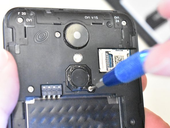

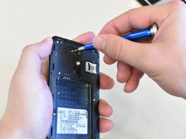

  3. LG Rebel 4 LTE Disassembly, Remove Screws: crwdns2935265:03crwdnd2935265:01crwdnd2935265:03crwdne2935265:0 LG Rebel 4 LTE Disassembly, Remove Screws: crwdns2935265:03crwdnd2935265:02crwdnd2935265:03crwdne2935265:0 LG Rebel 4 LTE Disassembly, Remove Screws: crwdns2935265:03crwdnd2935265:03crwdnd2935265:03crwdne2935265:0
    • Using the #000 Phillips screwdriver, remove all the screws (as seen in the photo).
    • There should be 12 screws in total.
    • Don't lose the screws!

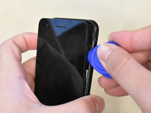

  5. LG Rebel 4 LTE Disassembly, Remove the Screen: crwdns2935265:05crwdnd2935265:01crwdnd2935265:03crwdne2935265:0 LG Rebel 4 LTE Disassembly, Remove the Screen: crwdns2935265:05crwdnd2935265:02crwdnd2935265:03crwdne2935265:0 LG Rebel 4 LTE Disassembly, Remove the Screen: crwdns2935265:05crwdnd2935265:03crwdnd2935265:03crwdne2935265:0
    • Rotate the phone (view picture) to reveal the top corner of the phone.
    • Using a opening pick, pry in between the glass screen and the framing.

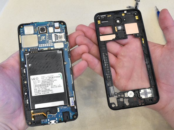

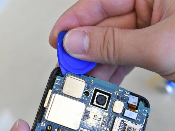

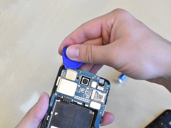

  6. LG Rebel 4 LTE Disassembly, Remove the Motherboard: crwdns2935265:06crwdnd2935265:01crwdnd2935265:03crwdne2935265:0 LG Rebel 4 LTE Disassembly, Remove the Motherboard: crwdns2935265:06crwdnd2935265:02crwdnd2935265:03crwdne2935265:0 LG Rebel 4 LTE Disassembly, Remove the Motherboard: crwdns2935265:06crwdnd2935265:03crwdnd2935265:03crwdne2935265:0
    • Pry from the top and bottom of the screen with the (refer to photo) opening pick to release the tabs holding the motherboard to the phone.
    • Do not let the main camera fall out while removing the mother board.

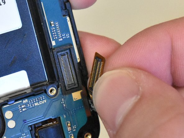

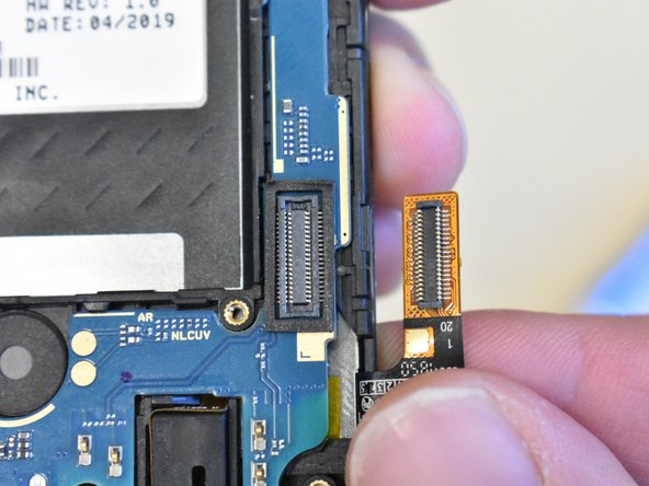

  7. LG Rebel 4 LTE Disassembly, Disconnect the Connector Cable: crwdns2935265:07crwdnd2935265:01crwdnd2935265:03crwdne2935265:0 LG Rebel 4 LTE Disassembly, Disconnect the Connector Cable: crwdns2935265:07crwdnd2935265:02crwdnd2935265:03crwdne2935265:0 LG Rebel 4 LTE Disassembly, Disconnect the Connector Cable: crwdns2935265:07crwdnd2935265:03crwdnd2935265:03crwdne2935265:0
    • On the bottom right of the phone, locate a cable that holds the motherboard to the phone.
    • Disconnect the cable by gently pulling up on the component with your fingers.
    • Do not use a prying tool or screwdriver to disconnect the cable.

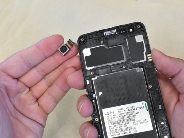

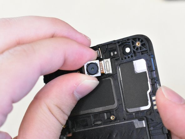

  8. LG Rebel 4 LTE Disassembly, Remove the Camera: crwdns2935265:08crwdnd2935265:01crwdnd2935265:03crwdne2935265:0 LG Rebel 4 LTE Disassembly, Remove the Camera: crwdns2935265:08crwdnd2935265:02crwdnd2935265:03crwdne2935265:0 LG Rebel 4 LTE Disassembly, Remove the Camera: crwdns2935265:08crwdnd2935265:03crwdnd2935265:03crwdne2935265:0
    • Separate the camera from the magnet by gently pulling up.
