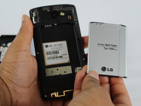

      • Slide a plastic spudger, or guitar pick, between the back and front panel at the bottom .
      • A metal spudger can easily damage your device. A plastic opening tool is always the only option.
    2. LG Power Screen Replacement: crwdns2935265:02crwdnd2935265:01crwdnd2935265:02crwdne2935265:0 LG Power Screen Replacement: crwdns2935265:02crwdnd2935265:02crwdnd2935265:02crwdne2935265:0
      • Carefully pop the back panel off and place it to the side.
    3. LG Power Screen Replacement: crwdns2935265:03crwdnd2935265:01crwdnd2935265:02crwdne2935265:0 LG Power Screen Replacement: crwdns2935265:03crwdnd2935265:02crwdnd2935265:02crwdne2935265:0
      • Use the thumb tab to remove the battery.

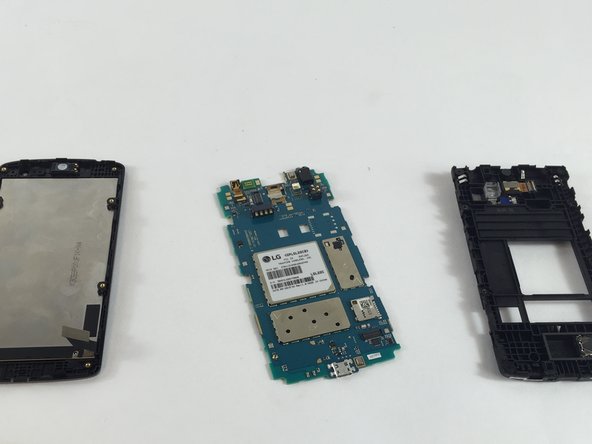

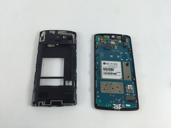

    1. LG Power Screen Replacement, Motherboard: crwdns2935265:04crwdnd2935265:01crwdnd2935265:01crwdne2935265:0
      • Remove the eight 4mm screws along the side of the mid panel using the Phillips #000 screwdriver head.
    2. LG Power Screen Replacement: crwdns2935265:05crwdnd2935265:01crwdnd2935265:02crwdne2935265:0 LG Power Screen Replacement: crwdns2935265:05crwdnd2935265:02crwdnd2935265:02crwdne2935265:0
      • Slide a plastic opening tool between the mid and front panel to remove the middle panel.
      • Place the mid panel to the side.

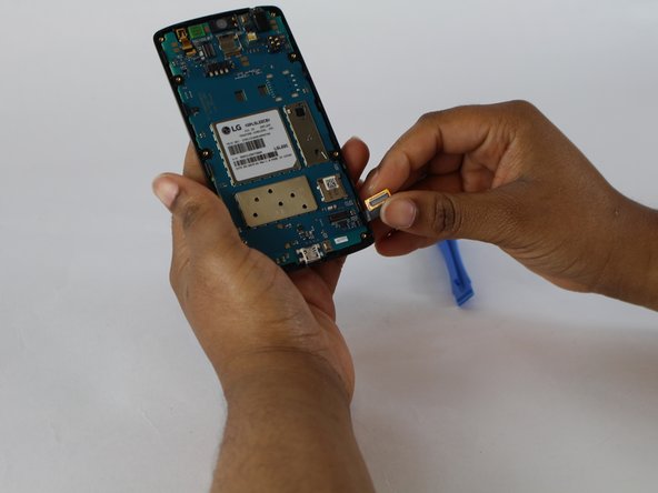

    3. LG Power Screen Replacement: crwdns2935265:06crwdnd2935265:01crwdnd2935265:03crwdne2935265:0 LG Power Screen Replacement: crwdns2935265:06crwdnd2935265:02crwdnd2935265:03crwdne2935265:0 LG Power Screen Replacement: crwdns2935265:06crwdnd2935265:03crwdnd2935265:03crwdne2935265:0
      • Detach the motherboard and touchscreen from each other by using a plastic opening tool.
      • The motherboard will then be free from the phone.

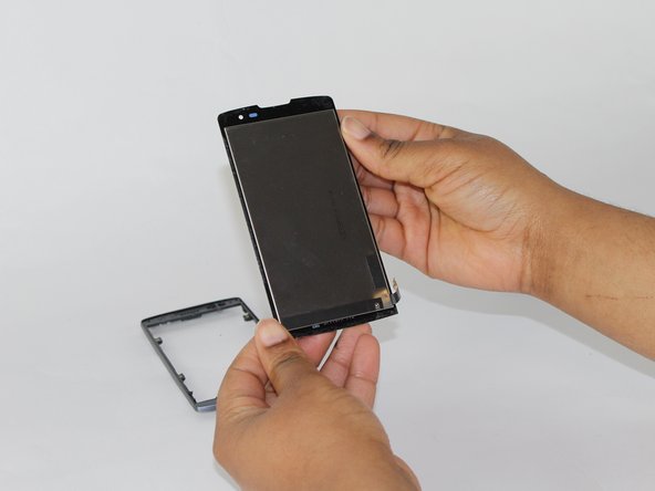

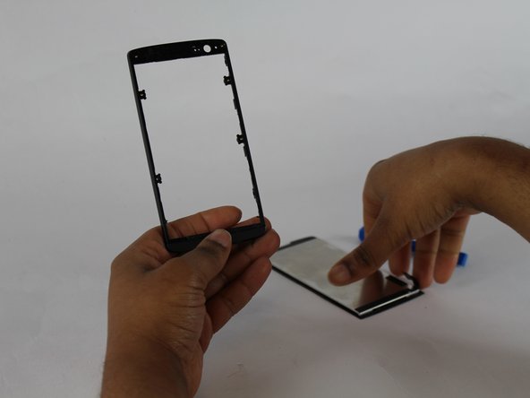

    1. LG Power Screen Replacement, Screen: crwdns2935265:07crwdnd2935265:01crwdnd2935265:03crwdne2935265:0 LG Power Screen Replacement, Screen: crwdns2935265:07crwdnd2935265:02crwdnd2935265:03crwdne2935265:0 LG Power Screen Replacement, Screen: crwdns2935265:07crwdnd2935265:03crwdnd2935265:03crwdne2935265:0
      • After removing the motherboard, slide a thin plastic opening tool between the screen and the frame.
      • This step may take awhile, because of the glue keeping the frame and screen together.

do i need a replacement screen?
jj - crwdns2934203:0crwdne2934203:0 crwdns2950251:0crwdne2950251:0
My screen is shattered otherwise the phone works fine..touch works and screen under glass is good. I want to replace the screen myself but my question is are the screen and digitizer fused (one piece) or can I just replace the glass screen? For an LG power x
Nikki - crwdns2934203:0crwdne2934203:0 crwdns2950251:0crwdne2950251:0
Did you ever figure out if there the same or separate. I'm needing to do the same.
sarahelizabeth0526 - crwdns2934203:0crwdne2934203:0 crwdns2950251:0crwdne2950251:0
i got the glass screen at amazonbot most digitisers have a ribbon wire to connecttheres doesnt..not sure if its just held on with 2 face tape??
