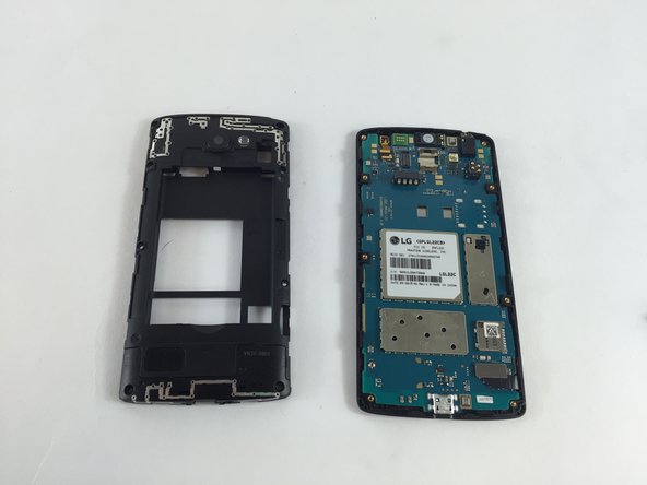

  4. LG Power Back Camera Replacement, Back Camera: crwdns2935265:04crwdnd2935265:01crwdnd2935265:01crwdne2935265:0
    • Remove the eight 4mm screws along the side of the mid panel using the Phillips #000 screwdriver head.
  5. LG Power Back Camera Replacement: crwdns2935265:05crwdnd2935265:01crwdnd2935265:02crwdne2935265:0 LG Power Back Camera Replacement: crwdns2935265:05crwdnd2935265:02crwdnd2935265:02crwdne2935265:0
    • Slide a plastic opening tool between the mid-panel and front panel to remove the middle panel.
    • Place the mid panel to the side.

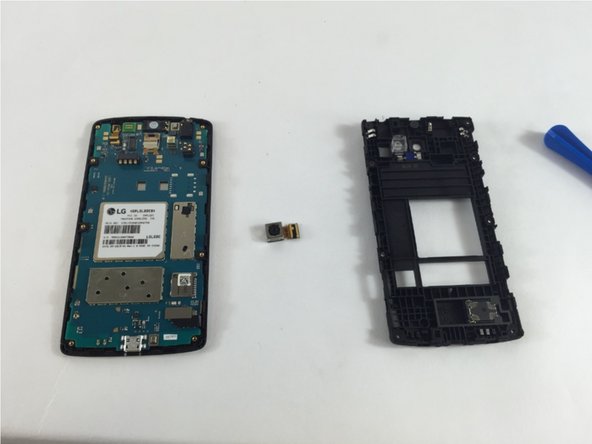

  6. LG Power Back Camera Replacement: crwdns2935265:06crwdnd2935265:01crwdnd2935265:02crwdne2935265:0 LG Power Back Camera Replacement: crwdns2935265:06crwdnd2935265:02crwdnd2935265:02crwdne2935265:0
    • Detach the back camera from the back of the mid panel using a plastic opening tool, and remove it.
    • The camera will be completely free at this point.
