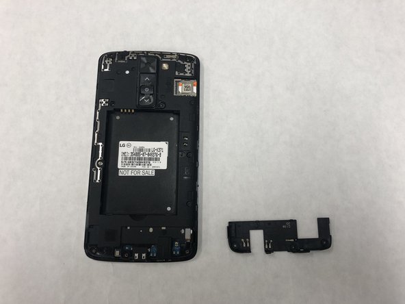

  3. LG Phoenix 2 Front Camera Replacement: crwdns2935265:03crwdnd2935265:01crwdnd2935265:02crwdne2935265:0 LG Phoenix 2 Front Camera Replacement: crwdns2935265:03crwdnd2935265:02crwdnd2935265:02crwdne2935265:0
    • Insert the opening tool under the bottom cover.
    • Pop off the bottom cover.

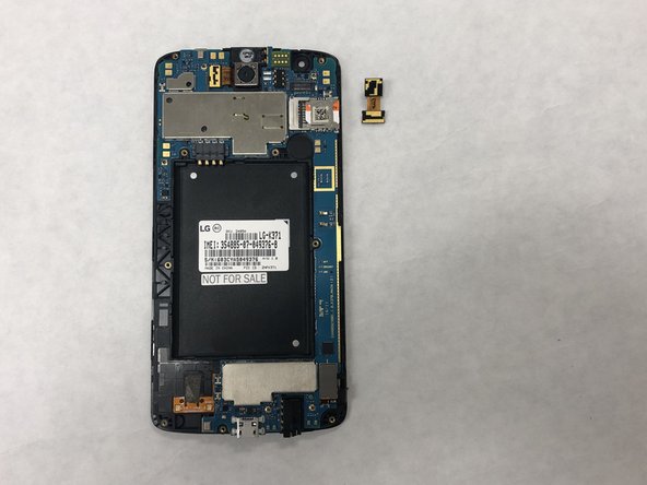

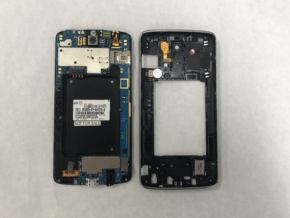

  4. LG Phoenix 2 Front Camera Replacement: crwdns2935265:04crwdnd2935265:01crwdnd2935265:01crwdne2935265:0
    • Remove eight 3mm screws using the Phillips #0 screwdriver.
  5. LG Phoenix 2 Front Camera Replacement: crwdns2935265:05crwdnd2935265:01crwdnd2935265:02crwdne2935265:0 LG Phoenix 2 Front Camera Replacement: crwdns2935265:05crwdnd2935265:02crwdnd2935265:02crwdne2935265:0
    • Insert the opening tool in between the phone screen and the silver trim.
    • Pop off the silver trim.
  6. LG Phoenix 2 Front Camera Replacement: crwdns2935265:06crwdnd2935265:01crwdnd2935265:02crwdne2935265:0 LG Phoenix 2 Front Camera Replacement: crwdns2935265:06crwdnd2935265:02crwdnd2935265:02crwdne2935265:0
    • Insert the opening tool under the bottom of the front camera connection to the motherboard.
    • Pop off the front camera.
