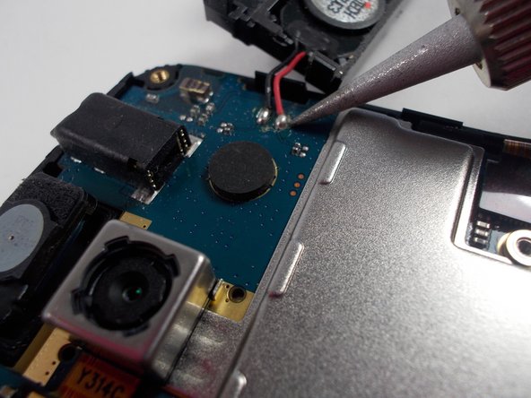

  8. LG Optimus V Speaker Replacement: crwdns2935265:08crwdnd2935265:01crwdnd2935265:02crwdne2935265:0 LG Optimus V Speaker Replacement: crwdns2935265:08crwdnd2935265:02crwdnd2935265:02crwdne2935265:0
    • To fix the speaker, use a soldering iron to heat up the two areas where the wires connect to the motherboard. Then, remove the old speaker and replace it with a new one by soldering it back onto the same areas.
    • Once you’re done, your speaker should be working properly again.
