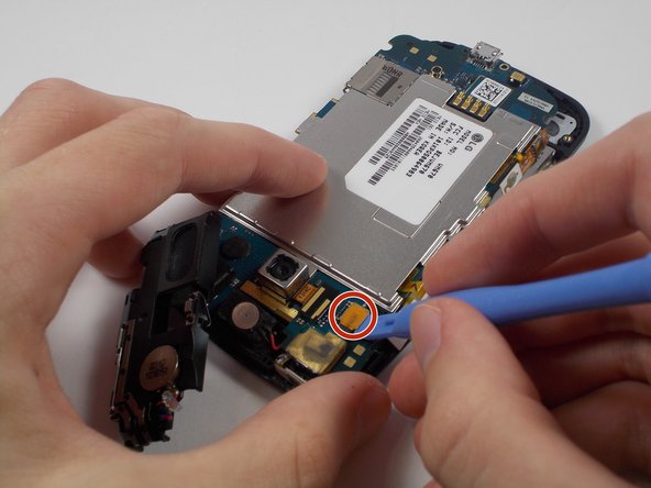

    • Use a plastic opening tool to remove each area holding the parts together.
  6. LG Optimus V Screen Replacement: crwdns2935265:06crwdnd2935265:01crwdnd2935265:02crwdne2935265:0 LG Optimus V Screen Replacement: crwdns2935265:06crwdnd2935265:02crwdnd2935265:02crwdne2935265:0
    • Use a plastic opening tool to remove the small black and yellow piece that reads Y3114C.
    • Use a plastic opening tool to pry off the camera.
