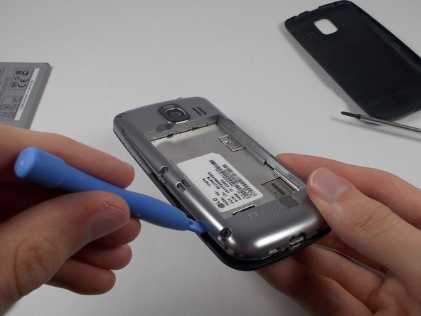

  4. LG Optimus V Camera Replacement, Camera: crwdns2935265:04crwdnd2935265:01crwdnd2935265:02crwdne2935265:0 LG Optimus V Camera Replacement, Camera: crwdns2935265:04crwdnd2935265:02crwdnd2935265:02crwdne2935265:0
    • Remove the six screws on the silver casing.
    • Use the plastic opening tool to remove the silver casing.

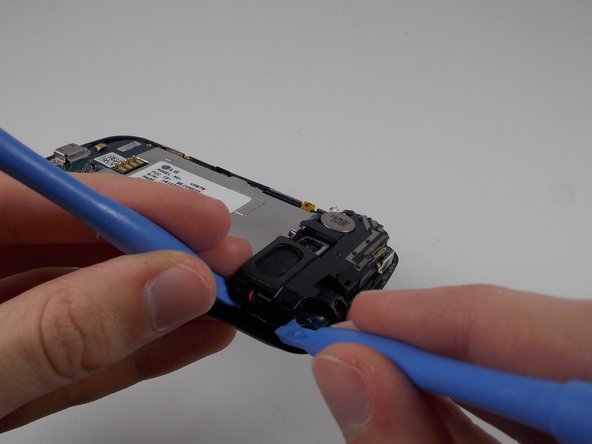

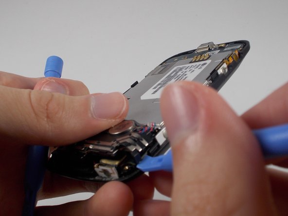

  5. LG Optimus V Camera Replacement: crwdns2935265:05crwdnd2935265:01crwdnd2935265:03crwdne2935265:0 LG Optimus V Camera Replacement: crwdns2935265:05crwdnd2935265:02crwdnd2935265:03crwdne2935265:0 LG Optimus V Camera Replacement: crwdns2935265:05crwdnd2935265:03crwdnd2935265:03crwdne2935265:0
    • Use a plastic opening tool to remove each area holding the parts together.

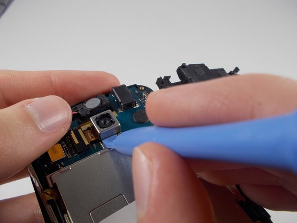

  6. LG Optimus V Camera Replacement: crwdns2935265:06crwdnd2935265:01crwdnd2935265:02crwdne2935265:0 LG Optimus V Camera Replacement: crwdns2935265:06crwdnd2935265:02crwdnd2935265:02crwdne2935265:0
    • Use a plastic opening tool to remove the small black and yellow piece that reads Y3114C.
    • Use a plastic opening tool to pry off the camera.
