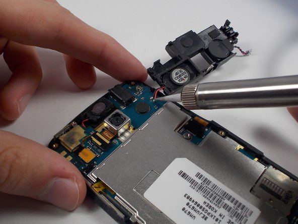

  7. LG Optimus V Antenna Replacement, Antenna: crwdns2935265:07crwdnd2935265:01crwdnd2935265:02crwdne2935265:0 LG Optimus V Antenna Replacement, Antenna: crwdns2935265:07crwdnd2935265:02crwdnd2935265:02crwdne2935265:0
    • Use a soldering iron to desolder the connections attaching the the antenna to the motherboard.
  8. LG Optimus V Antenna Replacement: crwdns2935265:08crwdnd2935265:01crwdnd2935265:01crwdne2935265:0
    • Solder off the antenna, and solder on the new one. The antenna is now replaced.
