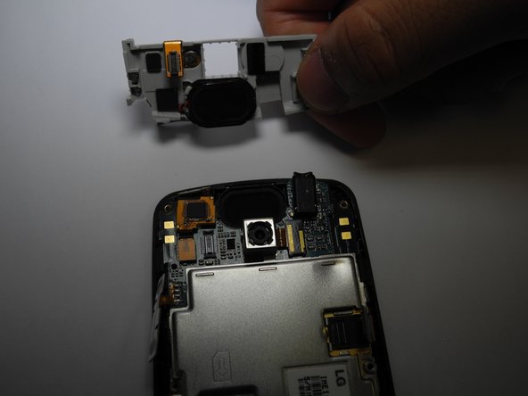

    4. LG Optimus T Screen Replacement: crwdns2935265:04crwdnd2935265:01crwdnd2935265:02crwdne2935265:0 LG Optimus T Screen Replacement: crwdns2935265:04crwdnd2935265:02crwdnd2935265:02crwdne2935265:0
      • Remove interior case. There are indentations on the top and bottom of the phone. Using a spudger, remove the interior case.
      • You might have difficulty popping the interior case off, and a more durable prying device may be needed.

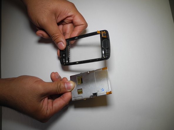

    9. LG Optimus T Screen Replacement: crwdns2935265:09crwdnd2935265:01crwdnd2935265:02crwdne2935265:0 LG Optimus T Screen Replacement: crwdns2935265:09crwdnd2935265:02crwdnd2935265:02crwdne2935265:0
      • Using a spudger, gently pry off the metal panel on the back of the screen attached by 4 retaining points.
      • Remove the screen from the front of your device.
