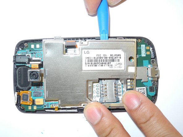

  7. LG Optimus T Camera and Camera Mount Replacement: crwdns2935265:07crwdnd2935265:01crwdnd2935265:02crwdne2935265:0 LG Optimus T Camera and Camera Mount Replacement: crwdns2935265:07crwdnd2935265:02crwdnd2935265:02crwdne2935265:0
    • Remove metal panel by inserting plastic opening tool into the four retaining points and remove panel
