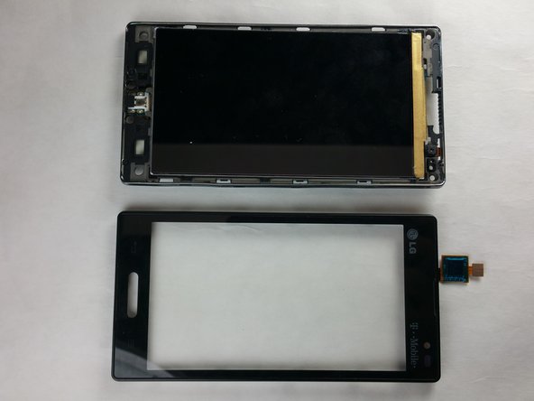

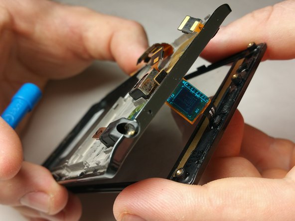

  5. LG Optimus L9 P769 VGA Front Facing Camera Replacement, Display Screen: crwdns2935265:05crwdnd2935265:01crwdnd2935265:01crwdne2935265:0
    • Using a spudger or small prying tool, pry off the latches that connects the digitizer to the chassis carefully.
    • Do not force open as the latches attaching the digitizer to the chassis as they are easily damaged.
  6. LG Optimus L9 P769 VGA Front Facing Camera Replacement: crwdns2935265:06crwdnd2935265:01crwdnd2935265:01crwdne2935265:0
    • Once the digitizer has been removed, turn the phone face down and remove the plastic housing for the front speaker. It should come off easily.

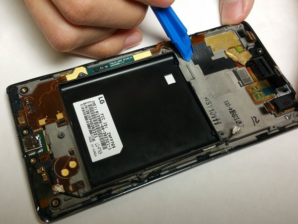

  8. LG Optimus L9 P769 VGA Front Facing Camera Replacement: crwdns2935265:08crwdnd2935265:01crwdnd2935265:03crwdne2935265:0 LG Optimus L9 P769 VGA Front Facing Camera Replacement: crwdns2935265:08crwdnd2935265:02crwdnd2935265:03crwdne2935265:0 LG Optimus L9 P769 VGA Front Facing Camera Replacement: crwdns2935265:08crwdnd2935265:03crwdnd2935265:03crwdne2935265:0
    • Remove the primary or rear camera using a small opening tool to remove the adhesive and lift the camera up using a pair of tweezers.
    • Using the same small opening tool, remove the connector that is taped to the chassis of the phone.
    • Make sure that every bit of the connector is no longer sticking to the chassis of the phone.
    • Similar to the digitizer, the connector should be able to slide through the hole of the chassis, completely detaching the LCD screen from the phone.

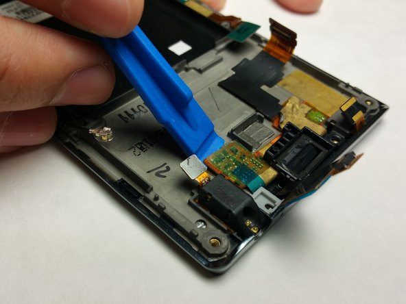

  9. LG Optimus L9 P769 VGA Front Facing Camera Replacement, VGA Front Facing Camera: crwdns2935265:09crwdnd2935265:01crwdnd2935265:01crwdne2935265:0
    • Once the screen has been removed, use a prying tool to lift off the front facing camera.
