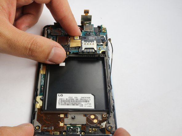

    • Pry the back panel from the frame of the phone to reveal the motherboard.

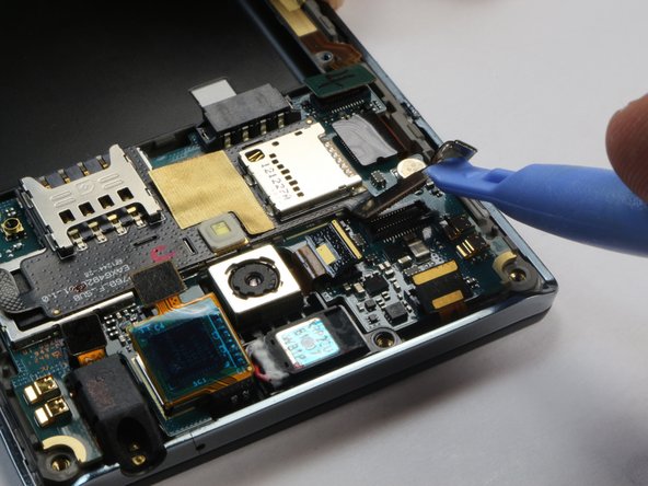

  2. LG Optimus L9 P769 Rear Facing Camera Replacement, Unpluging the Motherboard: crwdns2935265:02crwdnd2935265:01crwdnd2935265:03crwdne2935265:0 LG Optimus L9 P769 Rear Facing Camera Replacement, Unpluging the Motherboard: crwdns2935265:02crwdnd2935265:02crwdnd2935265:03crwdne2935265:0 LG Optimus L9 P769 Rear Facing Camera Replacement, Unpluging the Motherboard: crwdns2935265:02crwdnd2935265:03crwdnd2935265:03crwdne2935265:0
    • Detach the connectors on the motherboard.

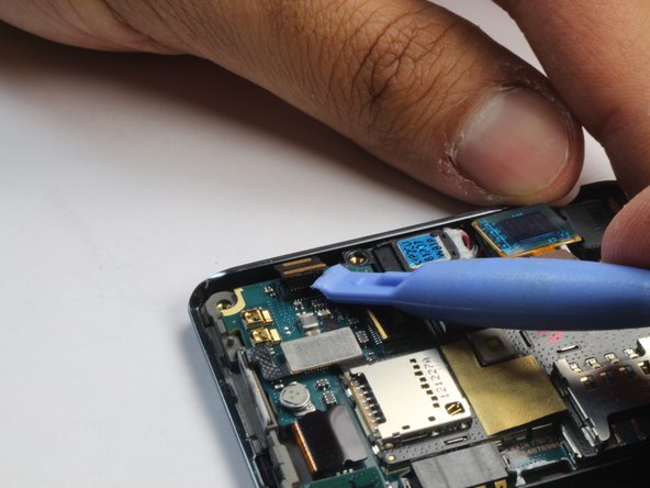

  3. LG Optimus L9 P769 Rear Facing Camera Replacement, Unpluging the Motherboard Cont.: crwdns2935265:03crwdnd2935265:01crwdnd2935265:03crwdne2935265:0 LG Optimus L9 P769 Rear Facing Camera Replacement, Unpluging the Motherboard Cont.: crwdns2935265:03crwdnd2935265:02crwdnd2935265:03crwdne2935265:0 LG Optimus L9 P769 Rear Facing Camera Replacement, Unpluging the Motherboard Cont.: crwdns2935265:03crwdnd2935265:03crwdnd2935265:03crwdne2935265:0
    • Continue to lift the connectors off the motherboard.

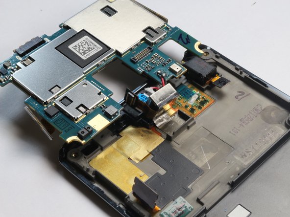

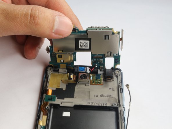

  4. LG Optimus L9 P769 Rear Facing Camera Replacement, Lifting Motherboard from the Phone: crwdns2935265:04crwdnd2935265:01crwdnd2935265:03crwdne2935265:0 LG Optimus L9 P769 Rear Facing Camera Replacement, Lifting Motherboard from the Phone: crwdns2935265:04crwdnd2935265:02crwdnd2935265:03crwdne2935265:0 LG Optimus L9 P769 Rear Facing Camera Replacement, Lifting Motherboard from the Phone: crwdns2935265:04crwdnd2935265:03crwdnd2935265:03crwdne2935265:0
    • Lift the speaker cable off the motherboard.
    • Lift the motherboard up. It will Still be connected to the frame.

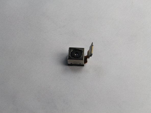

  5. LG Optimus L9 P769 Rear Facing Camera Replacement, Pry and remove the camera: crwdns2935265:05crwdnd2935265:01crwdnd2935265:03crwdne2935265:0 LG Optimus L9 P769 Rear Facing Camera Replacement, Pry and remove the camera: crwdns2935265:05crwdnd2935265:02crwdnd2935265:03crwdne2935265:0 LG Optimus L9 P769 Rear Facing Camera Replacement, Pry and remove the camera: crwdns2935265:05crwdnd2935265:03crwdnd2935265:03crwdne2935265:0
    • Pry under the camera to lift it off the frame.
    • There is some adhesive that will keep it attached to the frame, pulling the camera off will not damage the phone.
    • The camera should now be entirely separated from the phone.
