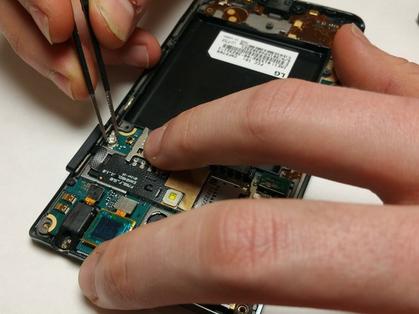

  3. LG Optimus L9 P769 Motherboard Replacement: crwdns2935265:03crwdnd2935265:01crwdnd2935265:03crwdne2935265:0 LG Optimus L9 P769 Motherboard Replacement: crwdns2935265:03crwdnd2935265:02crwdnd2935265:03crwdne2935265:0 LG Optimus L9 P769 Motherboard Replacement: crwdns2935265:03crwdnd2935265:03crwdnd2935265:03crwdne2935265:0
    • Using tweezers, pinch the sides of the antenna node and pull straight up.
    • Using a small prying tool, carefully remove the ribbon cables attached to the motherboard.
