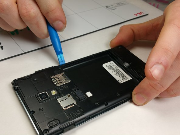

    • Remove all 10 of the 4.5mm screws that hold the back frame to the case of the phone using a PH000 screwdriver.
  4. LG Optimus L9 P769 Micro-USB Port Replacement: crwdns2935265:04crwdnd2935265:01crwdnd2935265:02crwdne2935265:0 LG Optimus L9 P769 Micro-USB Port Replacement: crwdns2935265:04crwdnd2935265:02crwdnd2935265:02crwdne2935265:0
    • Using a small prying tool, carefully remove the back frame by prying on the sides of the device.
    • Do be careful when prying back frame and removing it as too much force may result in damaging the frame.

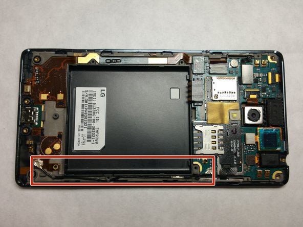

  5. LG Optimus L9 P769 Micro-USB Port Replacement: crwdns2935265:05crwdnd2935265:01crwdnd2935265:03crwdne2935265:0 LG Optimus L9 P769 Micro-USB Port Replacement: crwdns2935265:05crwdnd2935265:02crwdnd2935265:03crwdne2935265:0 LG Optimus L9 P769 Micro-USB Port Replacement: crwdns2935265:05crwdnd2935265:03crwdnd2935265:03crwdne2935265:0

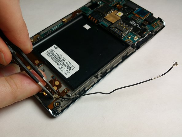

    • Remove both connections of the antenna by pulling up with tweezers

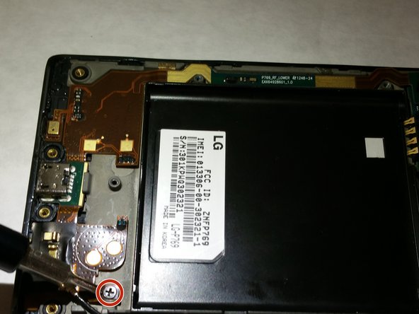

    • Remove Micro-USB Cache by unscrewing both 2.9mm screws with the PH000 headtype

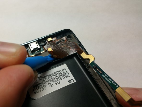

    • Detach module from motherboard using a prying tool

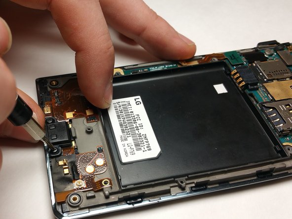

    • Remove 1.8mm screw to free Micro-USB module for removal using the PH000 headtype
  9. LG Optimus L9 P769 Micro-USB Port Replacement: crwdns2935265:09crwdnd2935265:01crwdnd2935265:02crwdne2935265:0 LG Optimus L9 P769 Micro-USB Port Replacement: crwdns2935265:09crwdnd2935265:02crwdnd2935265:02crwdne2935265:0
    • Use a small prying tool to detach the Micro-USB circuitry from the case of the phone

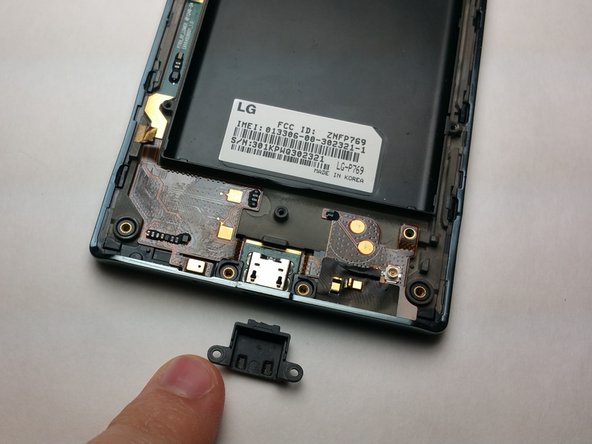

  10. LG Optimus L9 P769 Micro-USB Port Replacement: crwdns2935265:010crwdnd2935265:01crwdnd2935265:01crwdne2935265:0
    • Comparison showing the Micro-USB module against the empty phone casing
