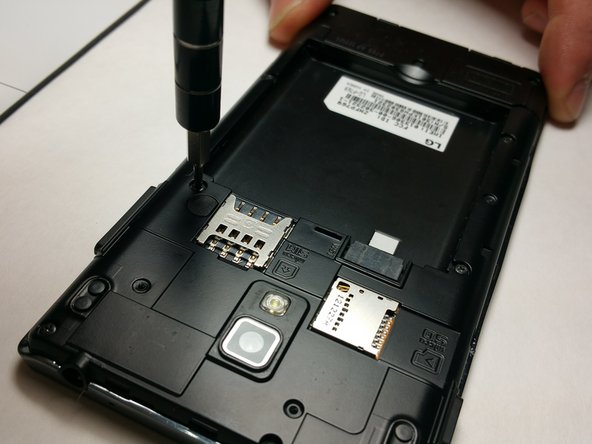

    • Begin the process with the device face down to remove the back cover. Remove the battery cover using your hands to access the inside of the phone.
  2. LG Optimus L9 P769 Antenna Replacement: crwdns2935265:02crwdnd2935265:01crwdnd2935265:01crwdne2935265:0
    • Remove the battery and set it aside.
  3. LG Optimus L9 P769 Antenna Replacement: crwdns2935265:03crwdnd2935265:01crwdnd2935265:02crwdne2935265:0 LG Optimus L9 P769 Antenna Replacement: crwdns2935265:03crwdnd2935265:02crwdnd2935265:02crwdne2935265:0
    • Use Philips PH000 to remove 10 screws located on back of device near the edges.
    • Screw length = 4.5mm (total of 10)
  4. LG Optimus L9 P769 Antenna Replacement: crwdns2935265:04crwdnd2935265:01crwdnd2935265:01crwdne2935265:0
    • Remove cover with small blue prying tool.
    • Take care not to break the slim frame around the battery slot.

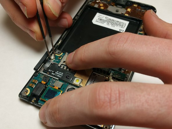

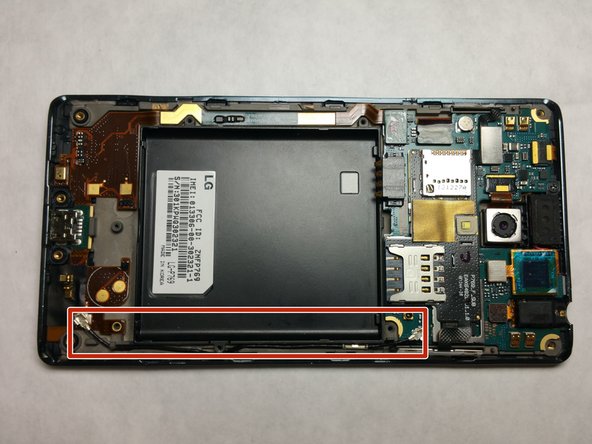

  5. LG Optimus L9 P769 Antenna Replacement: crwdns2935265:05crwdnd2935265:01crwdnd2935265:03crwdne2935265:0 LG Optimus L9 P769 Antenna Replacement: crwdns2935265:05crwdnd2935265:02crwdnd2935265:03crwdne2935265:0 LG Optimus L9 P769 Antenna Replacement: crwdns2935265:05crwdnd2935265:03crwdnd2935265:03crwdne2935265:0
    • Using tweezers, pinch the sides of the antenna node and pull straight up.
    • Additional pressure around the node may be required to ensure no other components come off.
