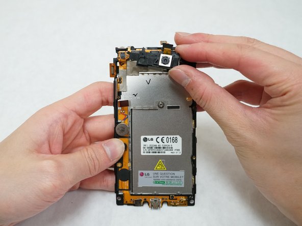

  2. LG Optimus L7 P705 Rear Facing Camera Replacement, Camera: crwdns2935265:02crwdnd2935265:01crwdnd2935265:01crwdne2935265:0
    • Lift the three connectors using the plastic spudger.
  3. LG Optimus L7 P705 Rear Facing Camera Replacement: crwdns2935265:03crwdnd2935265:01crwdnd2935265:02crwdne2935265:0 LG Optimus L7 P705 Rear Facing Camera Replacement: crwdns2935265:03crwdnd2935265:02crwdnd2935265:02crwdne2935265:0

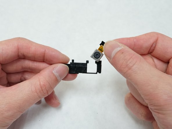

    • Starting from the right, remove the attached black mount using the plastic spudger.
  4. LG Optimus L7 P705 Rear Facing Camera Replacement: crwdns2935265:04crwdnd2935265:01crwdnd2935265:02crwdne2935265:0 LG Optimus L7 P705 Rear Facing Camera Replacement: crwdns2935265:04crwdnd2935265:02crwdnd2935265:02crwdne2935265:0
    • Apply some pressure on the back of the mount to detach the camera.
    • Replace the camera as needed.
