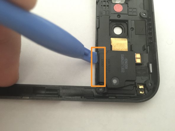

  6. LG Optimus G Pro Speaker Replacement, Speaker Removal.: crwdns2935265:06crwdnd2935265:01crwdnd2935265:02crwdne2935265:0 LG Optimus G Pro Speaker Replacement, Speaker Removal.: crwdns2935265:06crwdnd2935265:02crwdnd2935265:02crwdne2935265:0
    • The inner side of the inside cover houses the speaker module.
    • Use the plastic opening tool to pry the connection between the inner side and the speaker.
  7. LG Optimus G Pro Speaker Replacement, Completetion: crwdns2935265:07crwdnd2935265:01crwdnd2935265:01crwdne2935265:0
    • You now have removed the speaker for an easy replacement.
