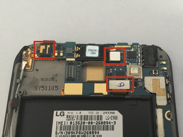

  6. LG Optimus G Pro Earpiece Speaker Replacement, Remove the Ribbon Cable: crwdns2935265:06crwdnd2935265:01crwdnd2935265:01crwdne2935265:0
    • Using your plastic opening tool, disconnect the connection between the phone and the ribbon cable. Make sure to use even pressure as you apply it to the cable.

  9. LG Optimus G Pro Earpiece Speaker Replacement, Remove Ribbon Cables: crwdns2935265:09crwdnd2935265:01crwdnd2935265:02crwdne2935265:0 LG Optimus G Pro Earpiece Speaker Replacement, Remove Ribbon Cables: crwdns2935265:09crwdnd2935265:02crwdnd2935265:02crwdne2935265:0
    • Use the plastic opening tool to disconnect the 4 ribbon cable connections and the antenna attached to the logic board.
