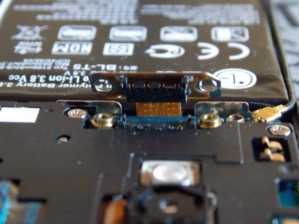

  4. LG Optimus G Battery Replacement: crwdns2935265:05crwdnd2935265:01crwdnd2935265:02crwdne2935265:0 LG Optimus G Battery Replacement: crwdns2935265:05crwdnd2935265:02crwdnd2935265:02crwdne2935265:0
    • Remove the the screws securing the battery cable connector.
    • Disconnect the battery cable.
