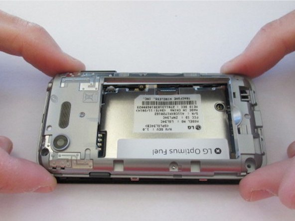

    • Use a Philips screwdriver to remove the six 1.4 mm screws. Set aside.
    • Use a plastic opening tool to remove the back panel.

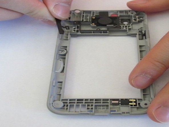

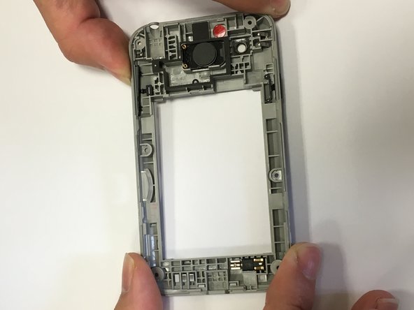

  4. LG Optimus Fuel Volume Button Replacement: crwdns2935265:04crwdnd2935265:01crwdnd2935265:03crwdne2935265:0 LG Optimus Fuel Volume Button Replacement: crwdns2935265:04crwdnd2935265:02crwdnd2935265:03crwdne2935265:0 LG Optimus Fuel Volume Button Replacement: crwdns2935265:04crwdnd2935265:03crwdnd2935265:03crwdne2935265:0
    • Remove the volume buttons by pressing on the outer edge.
