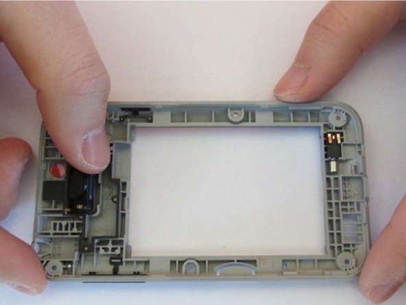

    • Use the opening on the right side of the phone to pull off the plastic back cover.
  2. LG Optimus Fuel Speaker Replacement: crwdns2935265:02crwdnd2935265:01crwdnd2935265:03crwdne2935265:0 LG Optimus Fuel Speaker Replacement: crwdns2935265:02crwdnd2935265:02crwdnd2935265:03crwdne2935265:0 LG Optimus Fuel Speaker Replacement: crwdns2935265:02crwdnd2935265:03crwdnd2935265:03crwdne2935265:0
    • Use the curved opening at the center-bottom of the battery to carefully remove the old battery.

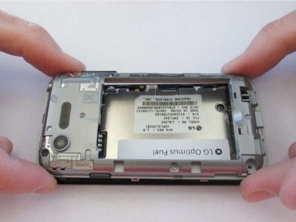

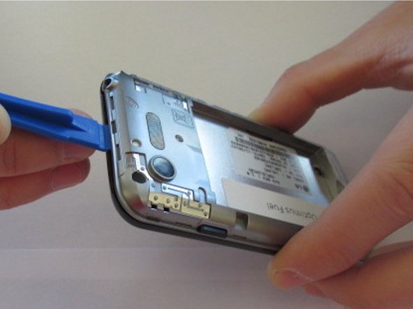

  3. LG Optimus Fuel Speaker Replacement, Speaker: crwdns2935265:03crwdnd2935265:01crwdnd2935265:03crwdne2935265:0 LG Optimus Fuel Speaker Replacement, Speaker: crwdns2935265:03crwdnd2935265:02crwdnd2935265:03crwdne2935265:0 LG Optimus Fuel Speaker Replacement, Speaker: crwdns2935265:03crwdnd2935265:03crwdnd2935265:03crwdne2935265:0
    • Remove the six 1.4mm screws using a Phillips head screwdriver with a size PH00 bit. Then fully remove the back panel with a plastic opening tool.

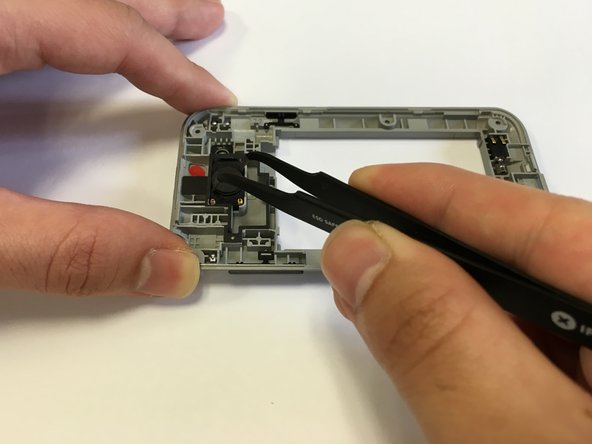

  4. LG Optimus Fuel Speaker Replacement: crwdns2935265:04crwdnd2935265:01crwdnd2935265:03crwdne2935265:0 LG Optimus Fuel Speaker Replacement: crwdns2935265:04crwdnd2935265:02crwdnd2935265:03crwdne2935265:0 LG Optimus Fuel Speaker Replacement: crwdns2935265:04crwdnd2935265:03crwdnd2935265:03crwdne2935265:0
    • Remove the speaker from the back panel. You may have to use some tweezers if you are having a hard time grabbing the speaker with your fingers.
    • Remember to take note of where the two springs on the speaker are positioned before removing it. Install the new speaker with the springs in this same position.
